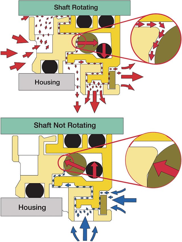

Figure 1. While the shaft is rotating, a micro-gap opens, allowing the thermal expansion in the bearing housing. While the shaft is not rotating, the micro-gap is closed, forming a perfect vapor seal (Images and graphics courtesy of AESSEAL)Dust Contamination

Manufacturers have developed more advanced labyrinth bearing protection seals that can offer protection against all types of contamination. For example, one seal that is non-contacting in operation to avoid shaft wear incorporates patented dynamic lift technology to protect against the breathing issues that contribute to 52 percent of all bearing failures centered around contamination. This dynamic lift technology uses the centrifugal force of rotating equipment to open a temporary micro-gap, allowing expansion of the oil and air mixture in the bearing housing, which allows the equipment to breathe. When the equipment stops rotating, the micro-gap immediately closes, forming a perfect seal. This prevents dust and moisture from being sucked back into the housing and therefore prevents contamination (see Figure 3).
Figure 3. While the shaft is rotating, a micro-gap opens, allowing the thermal expansion in the bearing housing. While the shaft is not rotating, the micro-gap is closed, forming a perfect vapor seal.
