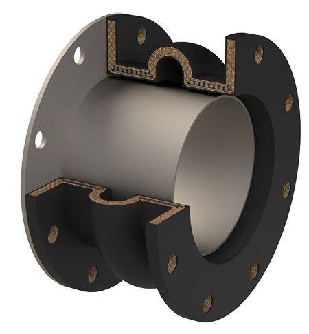

Wood logs are first debarked and then chipped into small pieces so they can later be converted to pulp. Blowers and conveyors send the wood chips from the storage silo to the mill, this is the first stage of the process where expansion joints can be used. Raw wood chips are abrasive and require an expansion joint with a filled arch to facilitate flow without chips accumulating in the arch. In addition to a filled arch, the tube elastomer should be rated to withstand heavy abrasion. Ethylene propylene diene monomer (EPDM), hydrogenated nitrile rubber (HNBR) or natural/gum rubber are best suited to handle these abrasive applications. Flow liners, also known as top hat liners, can also be used in this area when the velocity of the wood chips is high enough to damage the rubber liner. A flow liner is a metal insert that controls the flow of high velocity abrasives and protects the rubber tube without impeding the movement and vibration absorbing qualities of the expansion joint.

spool type with liner
IMAGE 4: Expansion joint with flow liner

Pulp slurry, at any point in the cleansing stages, has a high concentration of solids and is another example where an abrasive resistant liner is critical for the expansion joint. Natural/gum rubber, EPDM or HNBR are acceptable liner materials. In addition, a filled arch and/or flow liner configuration are ideal additions to avoid buildup of pulp material in the arch.
