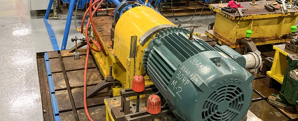

automated system for pump testIMAGE 1: Example of a pump test floor (Image courtesy of Viewpoint Systems Inc.)
Even if the setup for the test condition is to be manual, the new test system should automatically check that the condition is stable and in an acceptable range of a desired operating point before taking measurements. If not, the new test system should prompt the operator to correct the situation before proceeding.
