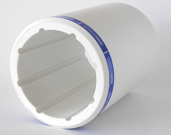

Different Types of BearingsImage 1. Bowl bearing. (Images courtesy of Vesconite Bearings)
