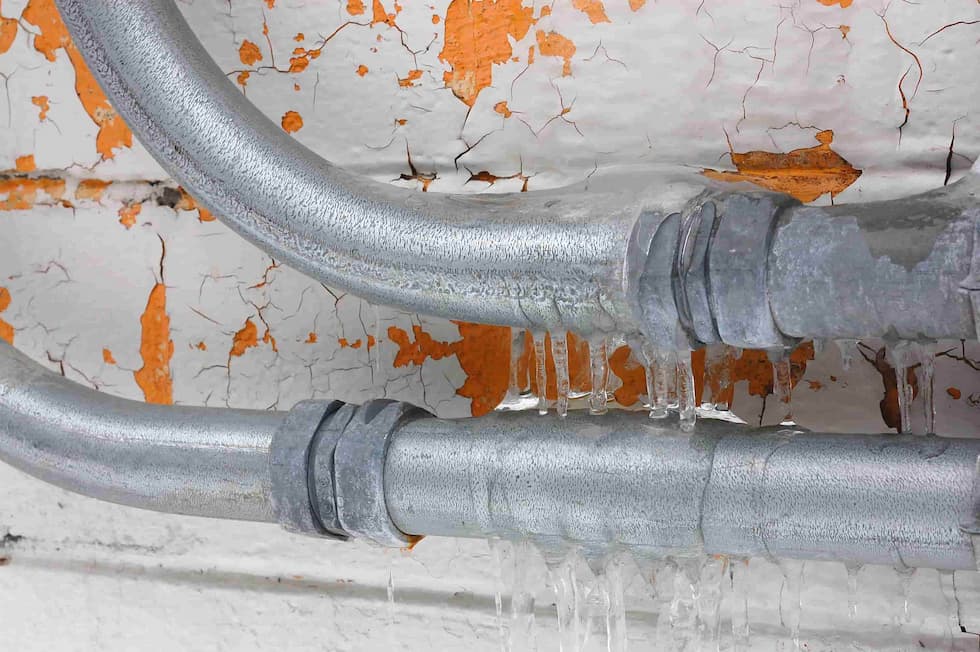

The Winter Storm Uri devastated Texas, leaving millions of people without electricity, heat and water for several days. The blackouts affected pump stations and caused low water pressure or outages in many areas of the state. Frozen pipes, sensors, filters and other components disrupted water treatment plants. Several cities urged residents to boil water before consumption. According to estimates, more than 10 percent of the approximately 7,000 different water systems statewide failed. In some places, generator failures at lift stations created sewage backups at homes.
As Texans take stock of the damage, water and wastewater utilities are asking one question: How can we prepare for a future event? In northern states like Illinois, where we live, utilities routinely prepare for winter storms as a matter of necessity. Many mitigation measures implemented are simple, practical and inexpensive. Some of the measures that Texas, or any state not as prepared for winter storms, can borrow from northern utilities include:
Find the Weakest Link
If a pressure transducer that senses the water level in a tank freezes, it can shut down the entire plant. When reviewing facilities, find the weakest link in the whole system and perform a risk assessment. For exposed small diameter lines, heat trace and insulate the pipe. Many northern treatment plants and pumping facilities use heat tracing to avoid freezing in the winter months. For exposed large-diameter pipes, insulate and keep water moving through it.
