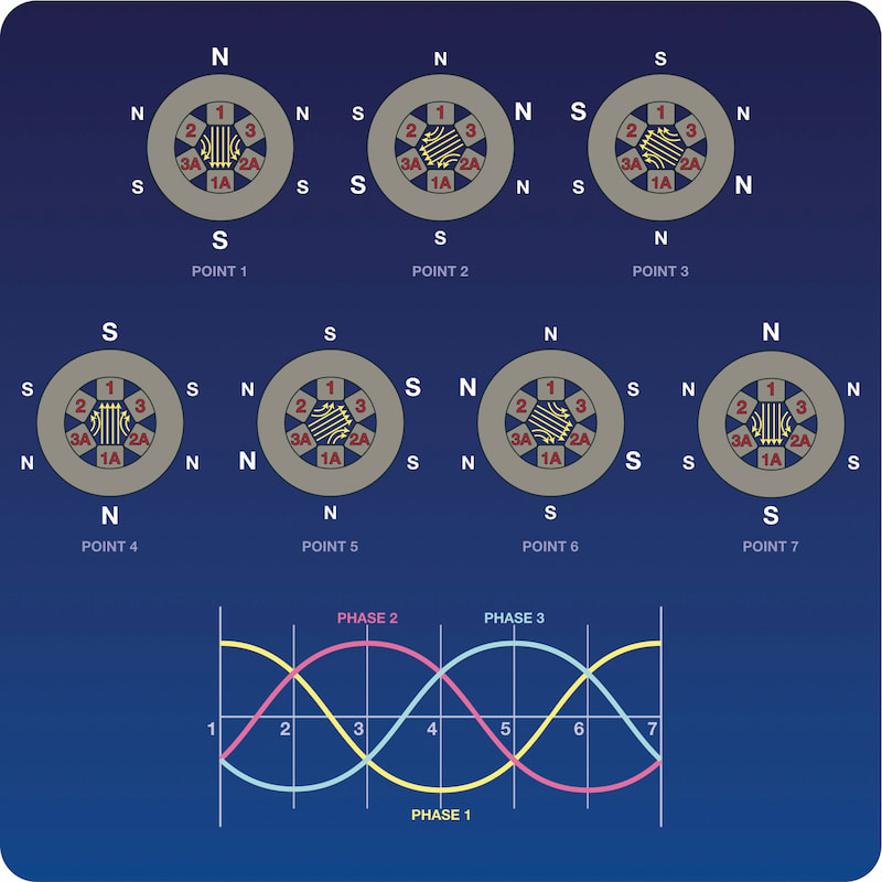

We have seen how the voltage can peak in a three-phase circuit and how the stator poles are aligned to match voltage peaks, but why does the rotational magnetic field occur automatically? Figure 4 puts the linear flow of voltage peaks shown in Figure 2 and the pole locations shown in Figure 3 into a rotational perspective.
| Figure 3. AC motor pole placement |
The stator images show the three sets of poles and their polarity from Points 1 through 7. The graph image shows the phase voltage peaks for the same points.
At Point 1, Phase 1 is at its positive peak and a maximum magnetic field is generated in Poles 1 and 1A. At Point 2, Phase 3 is at its negative peak and the maximum magnetic field is generated in Poles 3 and 3A. At Point 3, the maximum field has moved to Poles 2 and 2A.
If you study the other points you will see that this trend continues in a clockwise direction. As a result, the three phases create an automatic rotating field in the stator. If any two of the incoming phase leads are switched, the magnetic field will rotate in a counterclockwise direction.
Figure 4. The rotating magnetic field |
