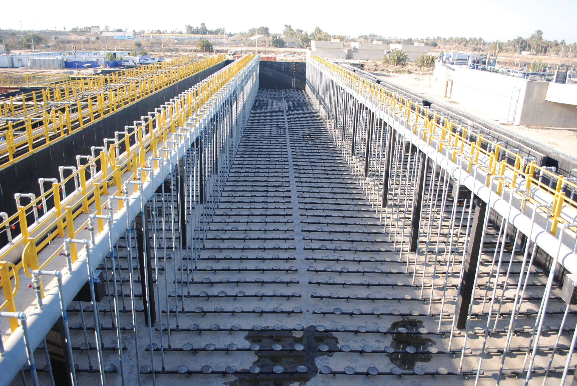

The RBBR process copes with fluctuating loads and conditions while producing a consistently high-quality final effluent. "The startup after successful completion of the $22 million Al-Kufa Wastewater Treatment Plant Expansion and Renovation Project is addressing the improvement needs of the facility equipment, water-quality concerns and population growth projections," said Adnan Abed Khudyer Al-Zurfei, the governor of Al-Najaf. The plant's RBBR process and operation partnership with the installer assists the city in meeting regulatory requirements. The returned biomass performance and effluent quality positively contribute to the local environment. The Al-Kufa expansion's limited footprint included two aeration tanks with individual turbine silo sections, clarifiers, pumps and a fully automated chlorine disinfection system. Also included were the headworks with split channel bar screens, twin-channel grit and grease removal equipment, auto screen, conveyor, flow diversion channels and a separate upstream pump station to accept the gravity-feed delivery.
The Al-Kufa expansion included two aeration basins, each with 2,300 12-inch fine-bubble disc diffusers. (Images courtesy of Turbo4Bio)
Several pumps serve the aeration basins and contribute to producing high-quality, low-odor effluent.MBBR/IFAS
