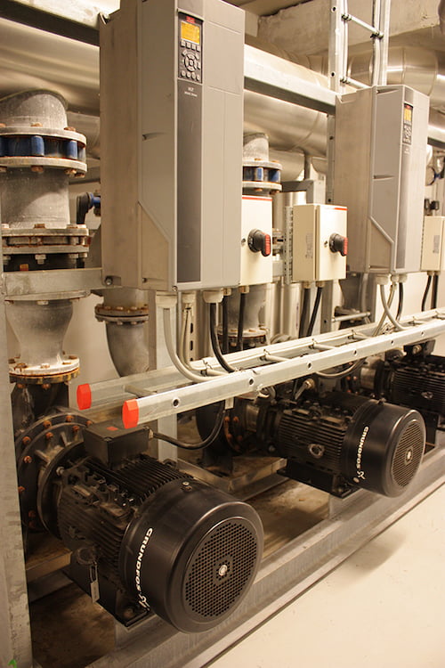

Grundfos delivered the pumps for the building’s air conditioning, heating and water boosting. The following products were supplied specifically for the ATES system:
- Six end-suction pumps with external frequency converters, which are the primary pumps in the building’s hydronic heating and cooling system
- Four end-suction pumps with internal frequency converters—two dedicated for the chillers’ condenser circuits and two dedicated for the chillers’ evaporator circuits
- One in-line pump with internal frequency converter, which serves as the primary cooling tower circuit and another as the secondary cooling tower circuit
