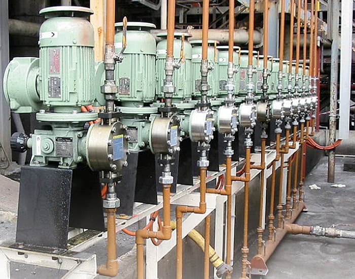

Image 3. Metering pumps with explosion proof motors in coal mine, part of the coal preparation plant. Several types of chemicals may be used to clean and process raw coal to remove inorganic matter, increase heat value, and meet customer specifications.
