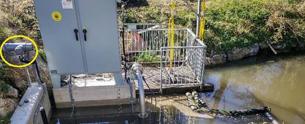

    IMAGE 2: Turbine pit before and after commissioning. Remote mounted controls (rear left), mounted above the shaft and separately from the actuator, provide the ability to operate the underwater actuator for turbine guide vane control.
