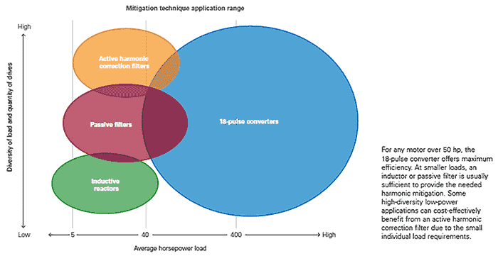

harmonics solutionsImage 1. Harmonics solutions (Image courtesy of Eaton)

Q: What are the different types of low harmonic solutions?
A: Inductive motors mitigate higher-order harmonics by providing high-input impedance that limits high-frequency currents. The 12-pulse converters consist of two parallel six-pulse converters fed by parallel isolation transformer paths, phase shifted 30 degrees, which mitigates fifth and seventh order harmonics. Passive filter technology provides high-input impedance for higher-order harmonics and a shunt-tuned reactor and capacitor to mitigate fifth and seventh harmonics.
Active harmonic correction filters actively measure and inject equal and opposite harmonics into the system, canceling most harmonic currents below the 49th harmonic.
Active front-end drives have insulated gate bipolar transistors (IGBT)—front-end technology that pulls relatively linear power from the line and uses an L-C-L (inductor-capacitor-inductor) filter to mitigate the IGBT switching noise.
The 18-pulse converters consist of three parallel six-pulse converters fed by a single-phase shifting autotransformer, phase shifted 20 degrees to cancel all harmonics below the 17th. Input impedance mitigates higher-order harmonics as well.
