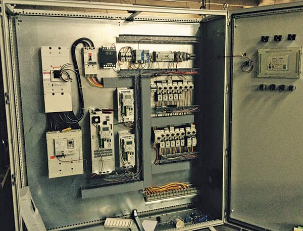

Three drives (Frames 1 and 3) are installed inside this control panel for an industrial conveyor. (Images courtesy of Eaton)

Heat is known to cause failure in many electrical devices, and AFDs are not exempt from this problem. Heat is generated through the AFD’s power conversion process and can be compounded by increased ambient temperatures. Most AFDs are rated for ambient operating temperatures up to 40 C (104 F) or 50 C (122 F), but when an application demands operation in higher temperatures, a few options are available. Users can choose a liquid-cooled AFD. A coolant is pumped through the drive to remove heat. This advanced cooling allows for a smaller footprint, but it requires a higher initial investment and requires additional maintenance. Another option for AFDs that are in an enclosure is to add increased ventilation or air conditioning. This solution may be practical for a large control cabinet that has other temperature sensitive components. However, it includes additional cost, increases space requirements and adds another potential point of failure. Another solution is de-rating the drive for the higher-than-rated ambient temperature. The drive’s internal cooling system includes the heat sink and cooling fan, which are designed to properly cool the drive when operating at its full-load rating. However, if a drive is not run at its full-load rating, the maximum heat generated does not reach the design limit, and excess cooling capacity exists. This excess cooling capacity can be used to run a drive at higher than normal ambient temperatures and is called de-rating. By using a de-rating factor, a higher rated drive can be used at less than its full rating in higher temperatures. For example, a 61-ampere (A) drive that is normally rated up to 50 C can operate at 60 C, but it is only rated for 44 A at the higher temperature. At this de-rating of 28 percent, the power modules do not generate as much heat. The cooling fan will adequately cool the AFD in the elevated ambient temperatures.
