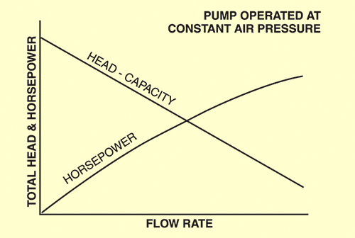

Although an AODD pump is a displacement type, it is actually a hybrid. While its pressure-versus-capacity characteristics resemble those of a centrifugal pump, it is best defined as a sealless, semi-positive displacement pump. The pumping principle provides 100 percent efficiency at zero flow (see Figure 1).
Figure 1. AODD head and horsepower versus flow rate

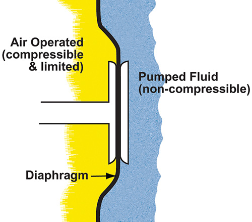

AODD pumps are air or natural gas operated and differ from other positive displacement pumps. Because of air pressure acting on the entire surface of the diaphragm, the diaphragm is in a balanced condition while pumping. This process extends the diaphragm life over that of mechanically operated diaphragm pumps. Because compressed air is limited, the maximum pressure developed by the pump is also safely limited. As a result, AODD pumps are appropriate for on-demand intermittent requirements (see Figure 2).
Figure 2. The balanced operation of an AODD pump

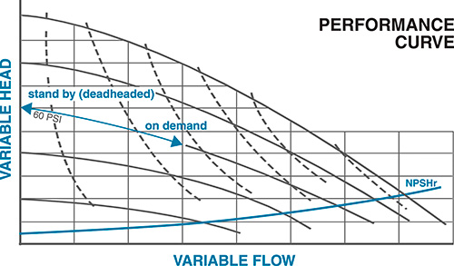

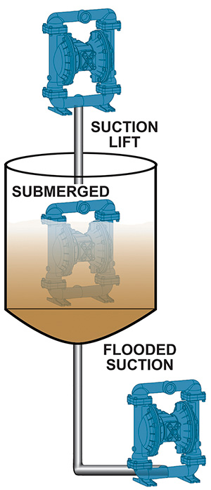

AODD pumps are self-priming from a dry start and are frequently installed in flooded suction and suction lift installations. With caution given to the non-wetted materials of construction, AODD pumps can be submerged for maximum installation versatility (see Figure 3). They safely operate on deadheaded/standby demand without the costs associated with the need to relieve pressure. At all deadhead condition points, they consume zero energy (see Figure 4).
Figure 3. AODD pumps can operate in many different environments
Figure 4. AODD pump performance curve
