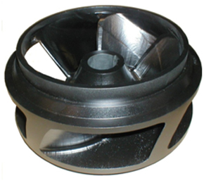

Figure 1. An engineered impeller
Fortunately, specialized engineering companies manufacture machined, structural-engineered pumps, impellers, rings, sleeves, bearings, bushings and mechanical seals. These pumps and pump components are computer-engineered and designed and are precision machined (not cast or molded) with the objective of maximizing longevity and reliability. For example, the impeller vane geometry can be engineered to maximize efficiency and performance specifically for the end user's system. The best part of these alternatives is that they are often competitively priced.

These impellers and pumps are 100 percent machined on the inside as well as the outside from solid blocks of the structural composite, which offers Superior Mechanical Strength, Perfect Balance, Better Performance, Smoother Surfaces, and Longer Life.
Figure 2. Both impellers ran for three years.  The structural composite impeller of Figure 1 looks like new.

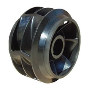

Figure 3. Engineered composite impellers, casing rings and diffusers do not corrode, are light weight, more efficient and have perfect balance.

Because alternative solution impellers are computer engineered, designed and precision machined, the impeller vane geometry can be engineered to maximize efficiency and performance. Problems such as recirculation, radial thrust and cavitation can be minimized or eliminated by upgrading to composite impellers and rings. Impeller vane shapes can easily be modified to provide the best shape for specific applications and performance requirements.
Figure 4 (below). Composite impeller vanes can be engineered for maximum efficiency
