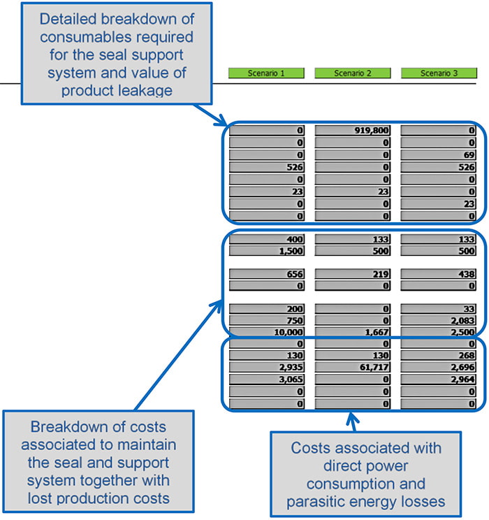

Figure 1. Summary of energy and life cycle costs (Graphics courtesy of FSA)Figure 1. Summary of energy and life cycle costs (Graphics courtesy of FSA)

Figure 2. Detailed cost breakdownFigure 2. Detailed cost breakdown
Using the default values in the LCC calculation tool and making some minor adjustments for this example, we can make a quick comparison of the three available scenarios.
The heat exchangers used in Scenario 1 and 3 are changed to water-cooled heat exchangers, so the seal support system will require water. Kerosene is selected for the Plan 32 injection fluid for Scenario 2, and the injection fluid value is increased. The value of the pumped fluid is also increased. Because this pump is considered critical, $5,000 per failure is selected to represent the impact to production in the event of a seal or system failure.
The pumping conditions and the expected mean time between failure (MTBF) are then added. A reduced MTBF for Scenario 1 is selected because the performance of the heat exchanger is expected to deteriorate over time as a result of the large heat load placed on it. The MTBF for the heat exchanger is also modified to match that of the seal, assuming the cooling coils require cleaning on a regular basis.
The purchase costs for the seal support systems are added. Scenario 1 requires a heat exchanger, stand and interconnecting piping. Scenario 2 requires interconnecting piping, instrumentation, as well as pressure and flow-controlling valves. A closed-loop barrier fluid circulating skid is selected for Scenario 3 with a significant initial investment of $50,000.
The results give a detailed breakdown of the annual operating costs, including the costs of parasitic losses. In this example, there is a significant difference in the one-time costs of the sealing solutions (see Figure 1). That difference is considered along with the operating costs over the projected life expectancy of a particular pumping asset. The resulting total estimated LCC suggests a different selection. The scenario with the highest initial cost turns out to be the one with the lowest LCC. The tool also provides a summary of the energy requirements and the carbon footprint of each solution.
