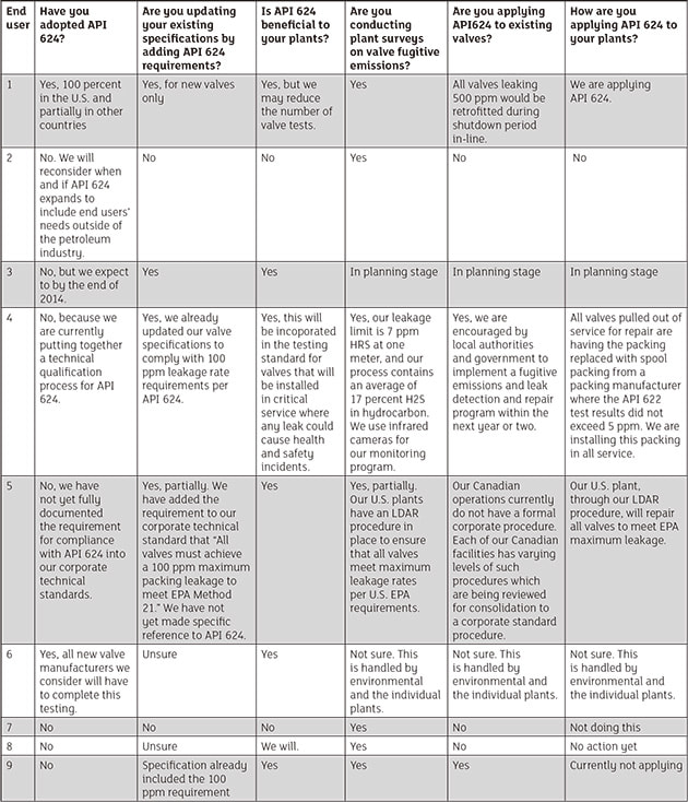

Leak screening should be completed on accessible components using a portable organic vapor analyzer in accordance with EPA Method 21 or by using alternate methods that provide an equivalent result. In some cases, Method 21 has been considered too slow and labor intensive, especially in small facilities. For these reasons, other methods may be used.
The industry should carefully monitor the implementation of API 624. Users should validate claims from valve manufacturers by requesting to view test results. Reputable test shops have noted:

An experienced testing company can provide guidelines to manufacturers about use of packing, valves, greases and testing requirements. Table 1 shows the results of an anonymous survey of end users concerning their adoption of API 624.
