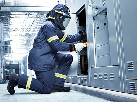

IMAGE 1: Proper arc-rated PPE can mean the difference between survivable injury and fatal trauma (Image courtesy of National Safety Apparel [NSA])

Personal Protective Equipment
Proper PPE does not eliminate the hazard but dramatically reduces the severity of injury during an arc event. A worker should be covered head to toe when in a high-risk area. Arc flash PPE includes flame-resistant clothing, arc-rated face shields and hoods, voltage-rated gloves with leather protectors, hard hats, hearing protection and dielectric safety footwear.
All PPE must be properly rated for the incident energy level, inspected before use, maintained in good condition and worn correctly at all times within the arc flash boundary. Arc flash boundaries and hazard categories determine the types of protective equipment required for safe work. For example, natural leather is often used in arc flash protective footwear because, unlike synthetic materials, it resists melting and burning. Heavy-duty leather is required for Hazard/Risk Categories (HRC) 2 and above or when incident energy transcends 4 cal/cm2.

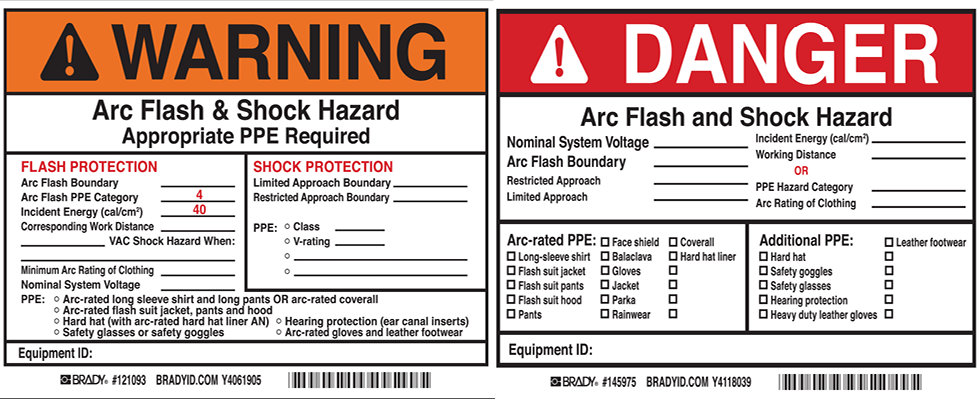

IMAGE 2: Proper arc flash warning labels like these must be properly placed to maximize visibility and in turn, worker safety. (Images courtesy of Brady)

Labeling
The first line of defense is arc flash warning labels, which are required on most energized equipment in regulated facilities.
These labels display nominal system voltage, arc flash boundary distance, incident energy level, required PPE category and shock hazard boundaries. These labels are critical for prejob planning and should never be ignored, covered or removed without reevaluation.
