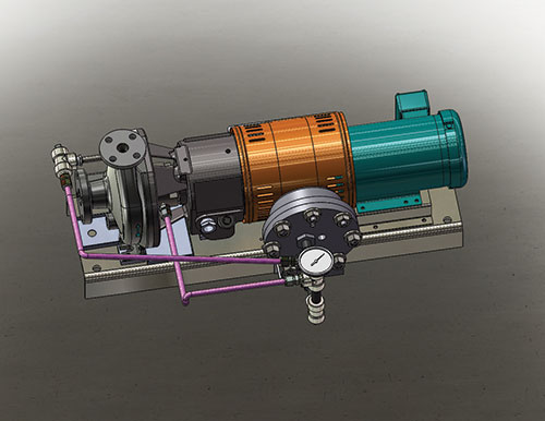

For temperatures below 250 F, a flush line routed from the pump’s discharge to the flush connection in the seal gland plate can remove the heat generated by the seal faces. For temperatures above 250 F, a heat exchanger—either American National Standards Institute (ANSI) Plan 7321 (API Plan 21) or ANSI Plan 7323 (API Plan 23)—is highly recommended. The heat exchanger must reduce the seal area temperature to about 160 F. Without a cooled flush, the liquid film between the seal faces will begin to flash. As the seal faces begin to run dry, the seal prematurely fails.
The ANSI Plan 7321 (API Plan 21) includes a flush line from the pump discharge through a heat exchanger and into the connection of the seal gland plate to flush the seal faces. The flow is controlled through an orifice, with the size determined by the differential pressure produced by the pump.
API Plan 21Figure 3. The API Plan 21 (ANSI Plan 7321) [Image courtesy of Ceco Environmental, Met-Pro Global Pump Solutions (Dean Pump)]
The ANSI Plan 7323 (API Plan 23) is a flush line from the seal chamber through a heat exchanger and back into the seal flush connection on the gland. This plan requires that the mechanical seal be equipped with a pumping ring to circulate the water through the heat exchanger. The advantage is that the heat exchanger cools water from the seal chamber, which has already been cooled by the jacket. The disadvantage is that it requires a pumping ring, which works poorly at slow speeds.
API Plan 23Figure 4. The API Plan 23 (ANSI Plan 7323) [Image courtesy of Ceco Environmental, Met-Pro Global Pump Solutions (Dean Pump)]
The use of a minimum flow bushing positioned in the bottom of the seal chamber is recommended for both plans. This bushing separates the cooler water in the seal chamber from the hotter water in the pump casing and reduces the amount of flow from the seal chamber back into the pump. The bushing assembly is provided with a carbon bushing and 316 SS retainer, set screws and springs.
These seal plans should be furnished with a thermometer and a needle valve located in the flush line between the cooler and the flush connection on the gland. Cooling water flow to the seal should be in the range of ½ to 1 gallon per minute, and the temperature should be near 140 F. Cooling water flow to the heat exchanger should be between 7 and 15 gallons per minute, depending on the heat exchanger. The needle valve allows close regulation of the flow.
Minimum flow bushingFigure 5. The minimum flow bushing limits the flow through the stuffing box. [Image courtesy of Ceco Environmental, Met-Pro Global Pump Solutions (Dean Pump)]
Adding a filter to ANSI Plan 7321 (API Plan 21) is highly desirable. A seal system consisting of a flush line from the pump discharge through a heat exchanger and then through a filter before returning to the flush connection in the seal gland plate offers an extra level of seal protection. This will filter out the welding slag, rust and scale common in most new hot water systems. It also cleans up an older system that may have scale. If the water has solids in solution, when cooled, they will precipitate or settle out and then filter in during flow. The seal system prevents solids from entering the seal chamber. These seal systems are furnished with a needle valve and thermometer.
Seal systemFigure 6. The seal system includes ANSI Plan 7321 (API Plan 21) with a filter to remove particulate. [Image courtesy of Ceco Environmental, Met-Pro Global Pump Solutions (Dean Pump)]
