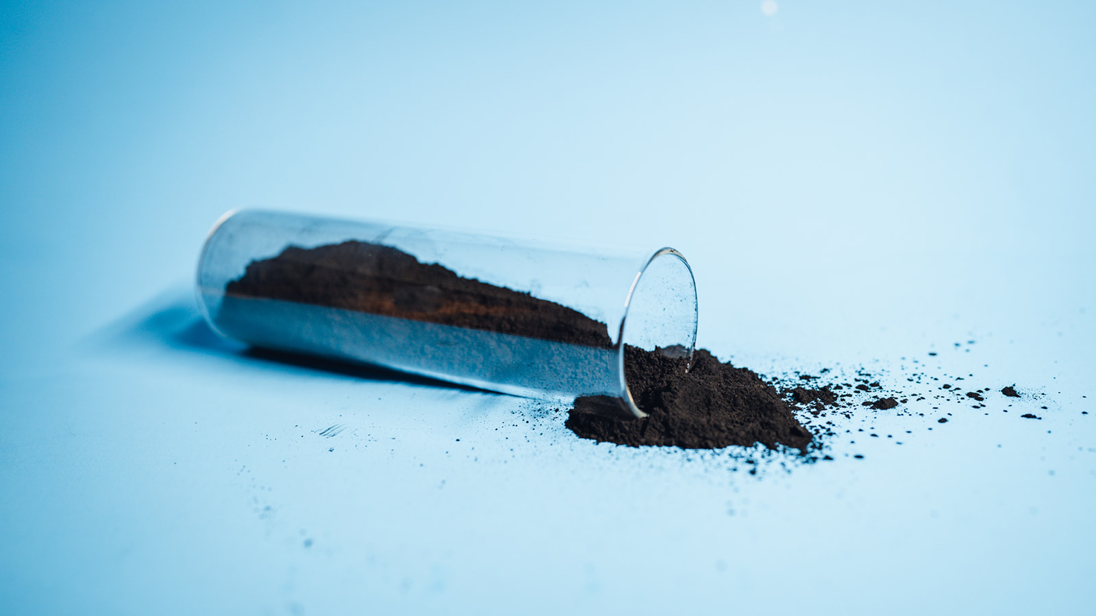

Advantages of Powdered Activated Carbon
Powdered activated carbon (PAC) offers flexibility and responsiveness in water treatment because it allows utilities to directly manage variability in water quality. Because PAC is added directly to the water as a fine powder, it provides rapid adsorption kinetics and can be dosed precisely to match changing contaminant loads, seasonal conditions or short-term water quality events. PAC is highly effective for a range of contaminants because of its small particle size and tunable surface chemistry and pore structure.
PAC particles expose adsorption sites almost immediately upon contact, enabling rapid uptake of dissolved organic contaminants without the long empty-bed contact times required by fixed media systems. This is especially valuable when raw water conditions change due to runoff events, algal blooms or episodic contamination. PAC can be injected at multiple points within a treatment system, including reservoirs, basins and existing process units, making it particularly valuable during emergency or disaster response scenarios. PAC can remain operational even if portions of a facility are offline, overwhelmed or damaged, providing a resilient treatment option when rapid response is critical.
From a surface chemistry perspective, PAC is well suited to interacting with the diverse organic matter present in natural waters. Its largely hydrophobic carbon surface preferentially attracts nonpolar and moderately polar organics, while oxygen-containing functional groups influence adsorption strength and selectivity. Utilities can select PAC grades optimized for higher micropore volume to target small, trace organics or a broader pore distribution to manage competing natural organic matter (NOM). Because temperature, pH and NOM concentration directly affect adsorption equilibria, PAC’s dose-based application allows operators to compensate in real time by simply adjusting feed rates.
PAC’s pore structure further supports performance under dynamic conditions. Micropores provide high adsorption capacity for low-molecular-weight contaminants, while mesopores improve diffusion and reduce fouling by larger organic molecules. This hierarchical pore network helps PAC remain effective even in waters with elevated organic loading.
When installed upstream of clarification, filtration or membranes, PAC reduces organic interference, protects downstream processes and helps other functions in the treatment train perform better. For example, when dosed in a system that already uses granular activated carbon (GAC), PAC can rein in contamination spikes and extend the life of downstream GAC.
Stored properly, PAC has a long shelf life and can be stockpiled as part of a utility’s emergency preparedness and disaster response planning, enabling rapid deployment without reliance on just-in-time delivery during disruptive events.
