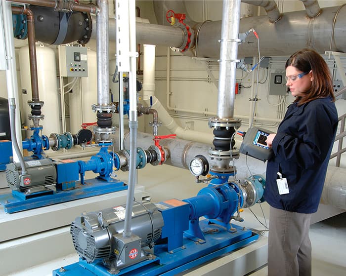

Image 2. Clamp-on ultrasonic flow meters can be used for troubleshooting a wide range of flow issues, from verifying the reading of another meter to monitoring flow systems over an extended time period.Identifying Selection Criteria
