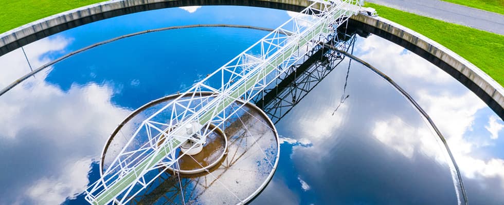

IMAGE 1: The capital investment (and space) required for aerobic treatment is usually greater than that needed for anaerobic facilities. (Images courtesy of HRS Heat Exchangers)

Some of the factors in favor of aerobic treatment include the fact that it has fewer odors (as hydrogen sulfide and methane are not produced), and nutrient removal from the wastewater to the sludge can be more efficient—meaning treated water can often be discharged directly into the environment. However, oxygenation of the wastewater can require large amounts of energy (or a large surface area for the treatment lagoon) and untreated biosolids can settle out from the process, requiring further treatment or disposal. The capital investment (and space) required for aerobic treatment is usually greater than that needed for anaerobic facilities.
