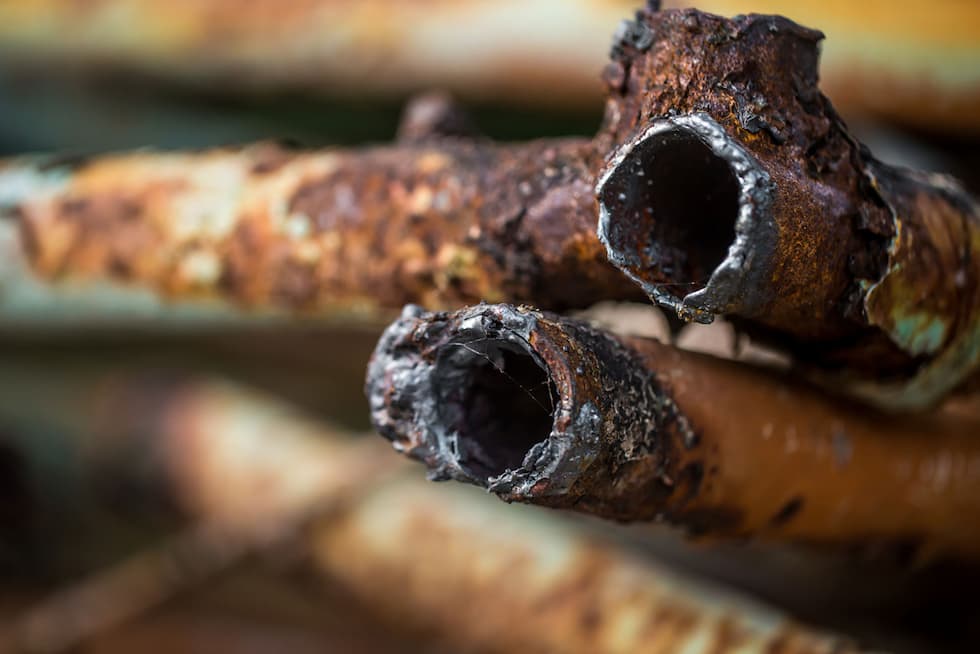

The benefits of insulating tanks, process equipment and pipework to reduce energy usage and the risk of personal injury by burns cannot be overstated. An unfortunate downside, however, is that if corrosion of the underlying steelwork is initiated, it often proceeds undetected until a dangerous loss of wall thickness results or, even worse, catastrophic failure occurs, leading to loss of containment. Corrosion under insulation (CUI) is, therefore, a major concern to facility maintenance engineers.
Steel will corrode when it is in contact with water and oxygen, so if water can penetrate the insulation, corrosion will likely result. Examples of possible causes include:

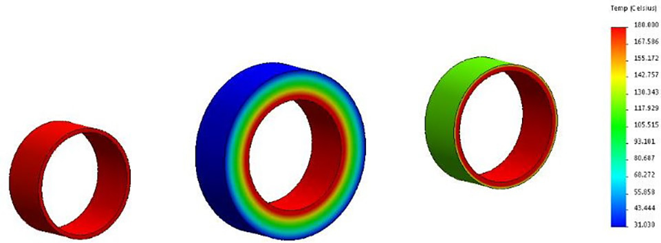

Using finite element analysis (FEA), the potential energy savings as a result of using a thermally insulating barrier coating system have been quantified. This study also compared temperature and heat losses with those of a more conventional insulating material: rockwool.
An 8-inch shed 40 stainless steel (304) pipe was used in this example. To compare the insulated and noninsulated pipe, three individual pipe models were designed and submitted to the same thermal constraints as follows:
  • Heat load: 356 F/180 C was applied to the inner surface of each three pipes
  • Convective losses: 7 watts per square meter kelvin [W/(m2K)] at an ambient temperature of 68 F/20 C was applied to the external surfaces of the three pipes
  • Radiative losses: it was assumed that all three pipes were of the same external surface emissivity (0.95) with a surrounding temperature of 68 F/20 C
IMAGE 3: Three-pipe system and the FEA mesh representation
Image 3 shows the three-pipe system and the FEA mesh representation. Each pipe is discretized into subelements that are used for each calculation point.
IMAGE 4: Illustrates the results of this analysis from Image 2
Image 4 illustrates the results of this analysis. With 5 mm of the thermally insulating barrier coating, the surface temperature is reduced by 105.1 F/58.4 C and the total heat loss is almost halved. As expected, the surface temperature and heat losses are lower when using 10 times the thickness of rockwool, but the thin layer of the thermal barrier coating still almost halves the heat loss from the pipe while providing corrosion protection and eliminating the risk of CUI.
Furthermore, by increasing the thickness of the thermally insulating barrier coating from 5 mm to 15 mm, both the surface temperature and heat flux can be further reduced by 34.3% and 45.3% respectively.
