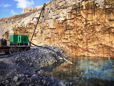

IMAGE 2: Temporary installation of a diesel-driven pump package used for dewatering mine pits

Temporary dewatering of mine pits
In this application case, a pump is used on a short-term basis at different locations across a mine site that does not have access to electrical power. For example, the pump is used to dewater a mine pit for four weeks, then moved to a different pit the next month and so on for a year or more at a time. Because this use case involves many short-term applications, powering a high-head pump with either an electric motor or a diesel engine yields total energy costs that are only within a few thousand dollars of each other.
However, in this example, the diesel set excels because of the lack of electrical availability at the site. The investment required to install electrical power would simply not be worth the effort; it would require site surveying, added time and additional crews. Plus, the new electrical would likely result in high voltage cables running across the site adding to safety issues. Bottom line: Diesel offers the better TCO for this type of installation.
