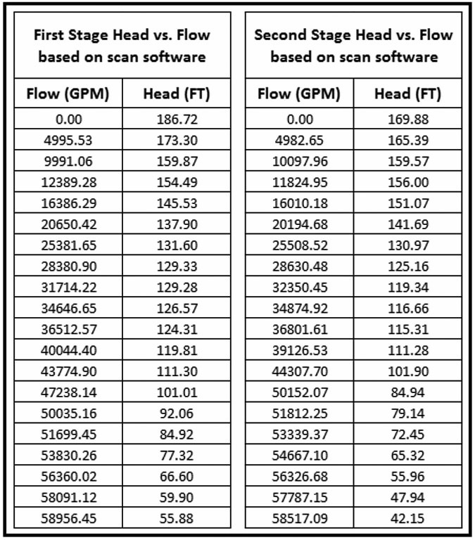

A set of sample calculations is provided in this section to demonstrate these steps. Assume that multiple, two-stage centrifugal pumps in parallel are used. Assume that the first stage performance is shown in Figure 1, and second stage performance is shown in Figure 2. Assume that both stages of each pump are equipped with a 29-inch impeller, corresponding to the top head curve shown in Figures 1 and 2. The head curves for each stage were digitized, and the resulting arrays are provided in Table 1. This same data could have also been determined by visual inspection and likely with fewer decimal places. It should be noted that the number of decimal places shown does not imply any more or less accuracy of the calculations based on such data, because the native spreadsheet stores more decimal places than those that are shown. The head versus flow arrays (see Table 1) for each stage can be fitted with a polynomial function that has sufficient order to provide a reasonably accurate representation of the data. For demonstration purposes, assume an eighth order polynomial that has the form shown in Equation 1 that gives the head rise in feet (FT).
- Range name of “Q1_DATA” will be assigned to the first stage flow rate values shown in the first column of Table 1.
- Range name of “H1_DATA” will be assigned to the first stage head rise values shown in the second column in Table 1.
- Range name of “Q2_DATA” will be assigned to the second stage flow rate values shown in the third column of Table 1.
- Range name of “H2_DATA” will be assigned to the second stage head rise values shown in the fourth column of Table 1.
