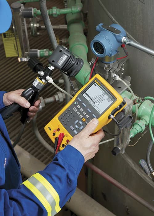

Image 2. A multifunction process calibrator and a portable pressure pump are critical when calibrating pump sensors.Smart Calibration
A new generation of smarter field calibration tools is increasing worker productivity by consolidating multiple tools into one unit and performing functions beyond basic test and measurement, such as assisting with analysis and documentation. Multifunction documenting process calibrators are handheld, electronic test tools that measure pressure, temperature and a wide variety of electrical and electronic signals. Benefits include:- Fewer tools that technicians need to keep with them in the field and be trained to use
- Similar calibration processes and data output across multiple devices, compared with a different process to collect a different set of data from each tool and device
- Automated procedures that replace many manual calibration steps
- No second technician required to record the as-found and as-left state of the field device
- Faster calibration time
- Error calculation of a single tool rather than having to add the errors of several tools The biggest savings from using a documenting calibrator comes from the route management tool built into the device. Using a single set of permits and paperwork for an entire set of calibrations reduces costs considerably. Calibrating multiple instruments in the course of a route reduces the cost per calibration, compared with individually calibrating single instruments.
