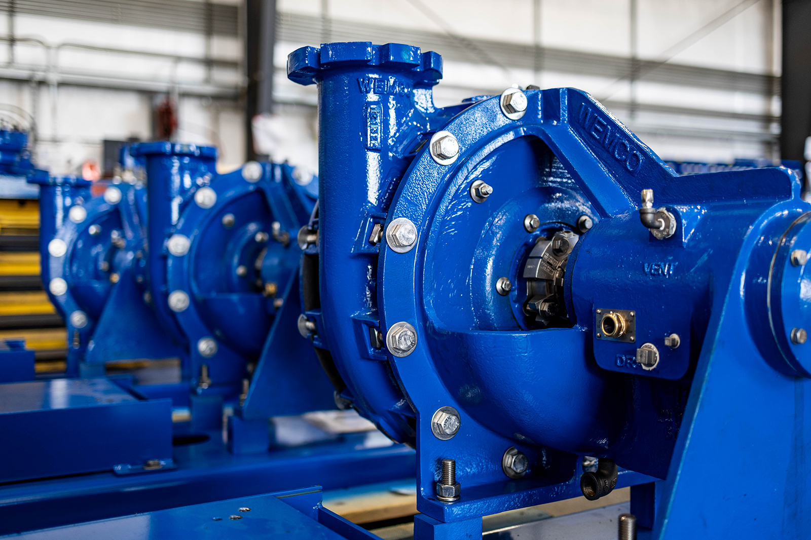

Lighting is the hardest part of photographing pumps because it’s rarely under your control. I work almost entirely with natural and existing shop lighting (whatever comes through the bay doors or overhead fixtures). You learn quickly that reflections and glare are your constant enemies, especially on painted or stainless surfaces.
The trick is to move yourself, not the light. I look for the right angle where reflections fall off and the shape of the pump stands out cleanly. If it’s too reflective, a polarizing filter helps reduce shine and deepen color. When the light is streaming through a bay door, I’ll often position myself so the pump is front-lit and facing into that light source. It keeps details crisp and colors accurate.

If you only remember one thing about photographing pumps, remember this: get low.The best angle is usually the front quarter, not dead-on, not straight from the side but somewhere in between. From that position, the pump’s body and flanges line up in a way that shows both depth and form. If you shoot from a slightly lower height and tilt upward, the front of the pump feels larger, almost monumental. Everything behind it gradually recedes, which exaggerates its size and gives it presence.

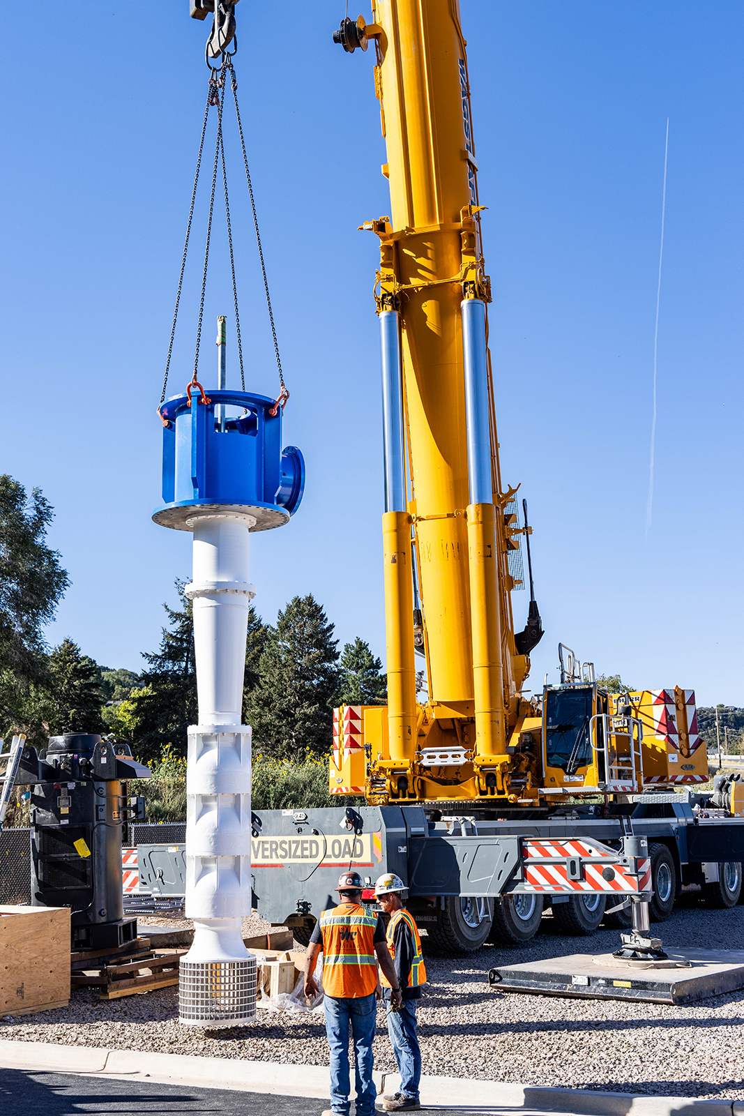

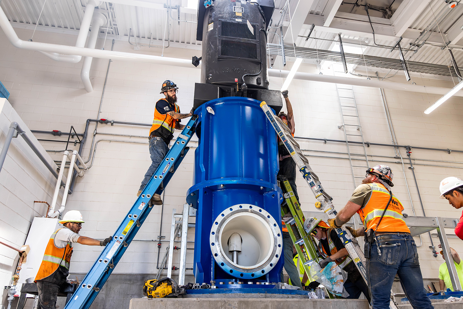

When I’m on-site at an installation, I especially enjoy photographing crane lifts. Seeing a massive pump suspended mid-air, whether it’s being installed or positioned for alignment, tells a story of teamwork and capability that’s hard to capture any other way. Including people in those frames adds a powerful sense of scale and collaboration. Those moments highlight not just the equipment, but the people and partnerships that bring these machines to life.

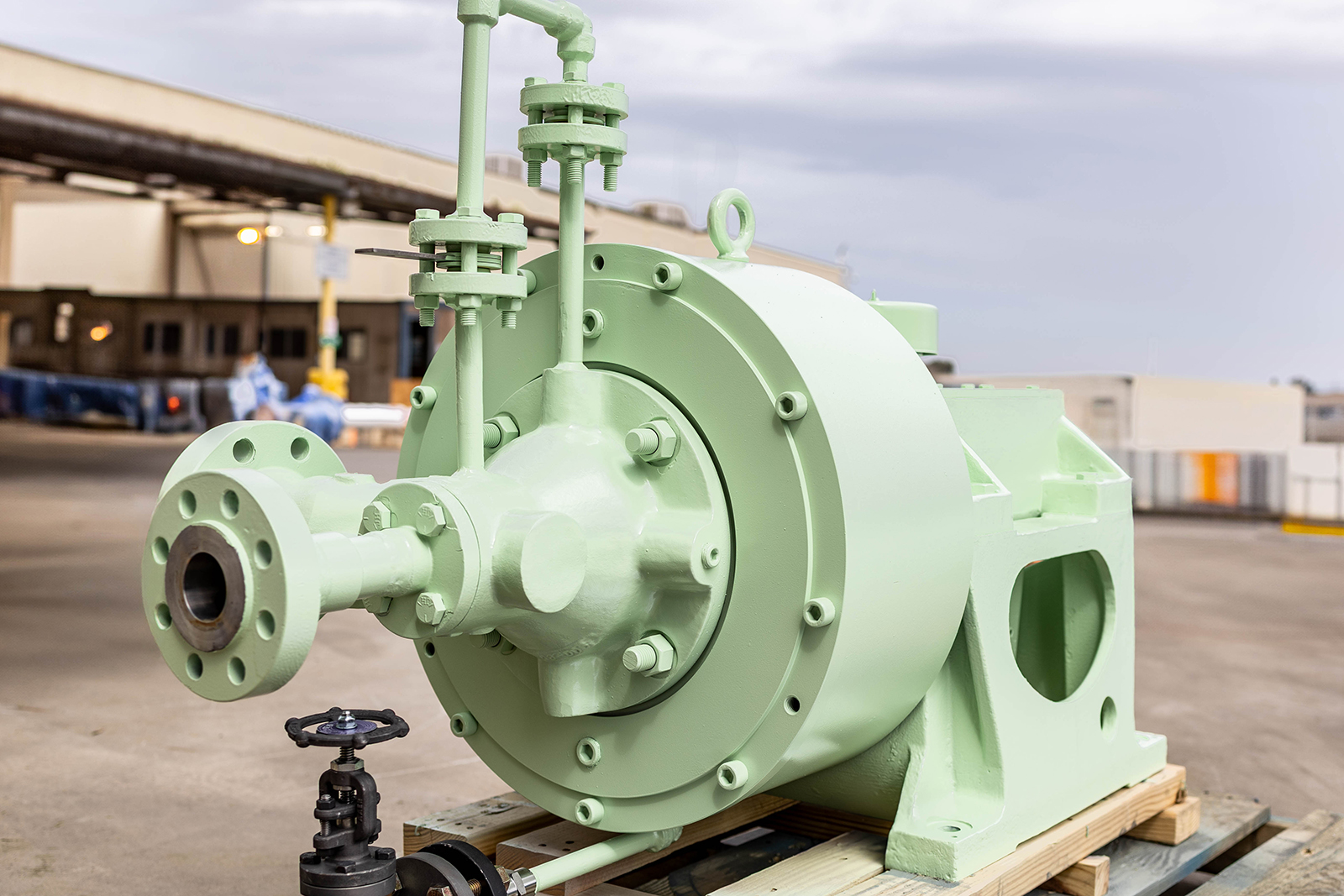

Industrial photography isn’t about perfection; it’s about honesty. Some shots will be glossy and symmetrical. Others will have shadows, dust or scuffed paint. Those things give a pump its character. When you photograph something that’s built to move the world’s essential materials, it doesn’t need to look delicate. It just needs to look real.
In fact, I’ve taken some of my favorite photos by embracing these imperfections. A casting waiting to be machined might sit outside long enough to pick up a layer of rust, and when the sunlight hits it just right, it becomes something special. The texture, the color and the rawness tell a different story about the materials and the process behind them. Sure, it might not be the best fit for a marketing brochure, but for my own archive, those are the kinds of shots that remind me why I enjoy this work. There’s art in the everyday details if you take the time to look for it.
