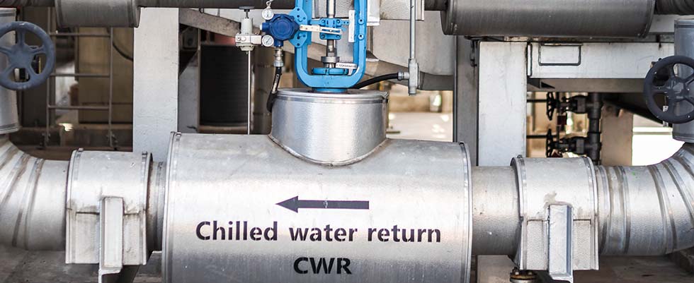

A key design element of the project was the split system design, which consists of a main control panel and three remote panels. This was chosen to accommodate the distribution of equipment across the facility. One challenge identified in the planning of this project was the distances between the control panels, which at times exceeded the standard 100-meter range of traditional Ethernet cabling. To overcome this, fiber optic cables were used as the communication medium, extending the range to up to 2,000 meters.
Beyond meeting current connectivity needs, using fiber optic cables provides additional scalability to support future expansion or system modifications without major infrastructure changes. This approach ensures the communication backbone of operations remains reliable and delivers high-speed, interference-free performance as the facility expands or adopts new technologies.
Field instrumentation plays a vital role in achieving precise control over the chilled water network. Advanced sensors and monitoring tools, such as pressure sensors, flow meters, temperature monitors, pumps, control valves and heat exchangers, ensure every aspect of the system operates efficiently and reliably.
The integration of a human-machine interface (HMI) further enhances the system’s usability. By consolidating data from the remote panels and field instrumentation, the HMI provides operators with a view of all critical metrics, including pressure, flow rates, temperature and equipment status. Centralized monitoring of subsystems is essential for making informed decisions, quickly addressing system irregularities and using predictive maintenance to prevent potential issues before they arise.
