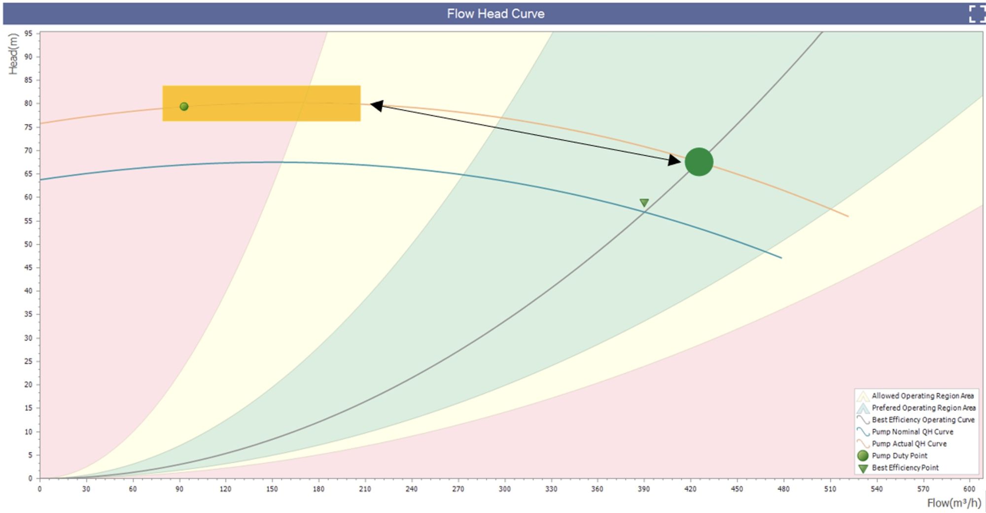

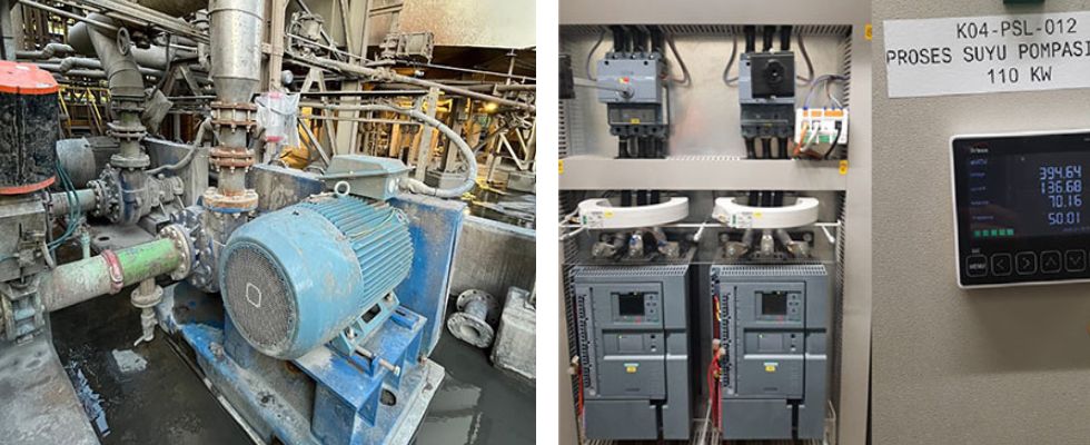

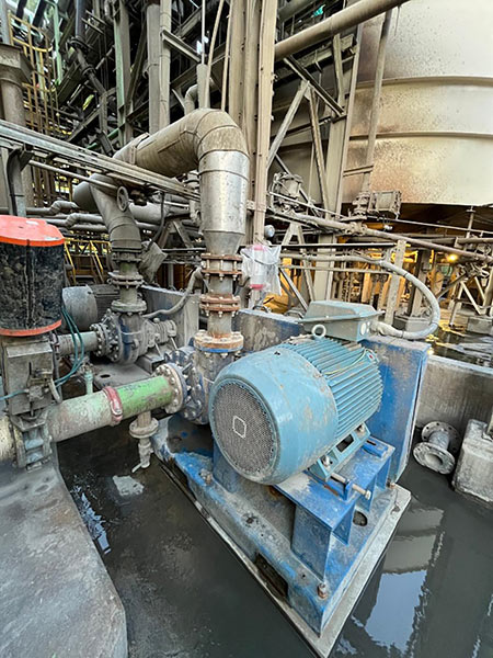

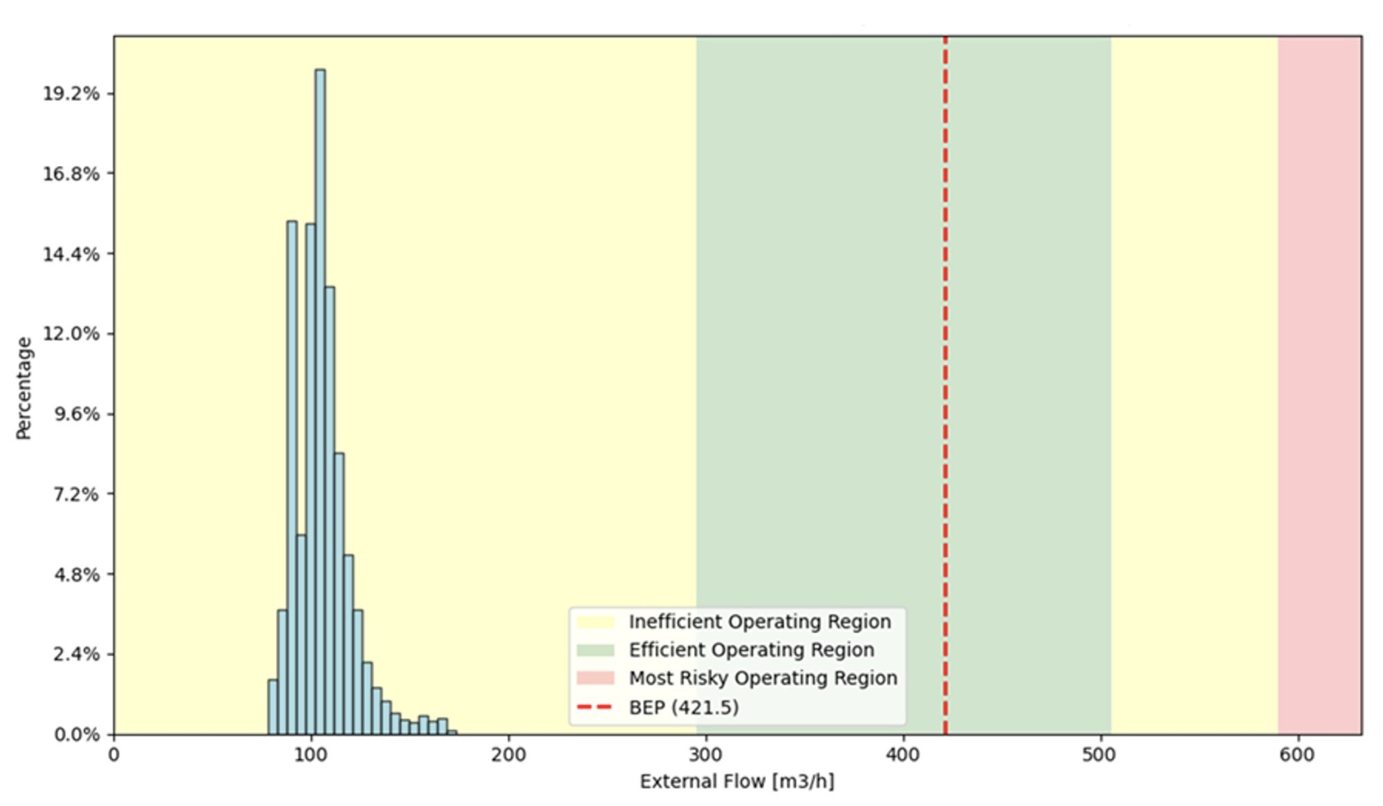

The pump under review, a process water unit with a 110 kW motor, was designed for a nominal flow of 421.5 meters cubed per hour (m³/h) at its BEP. The installed continuous monitoring ESA system, however, revealed it frequently operated at 90-115 m³/h—well below its optimal range. This mismatch, common in oversized legacy systems, resulted in efficiencies between 40% and 60%, with annual energy consumption reaching 602,880 kilowatts per hour (kWh).
Several issues compounded the inefficiency. A belt-and-pulley drive system, increasing shaft speed from 1,480 rotations per minute (rpm) to 1,630 rpm, added a 2% energy loss. More critically, operating outside the BEP heightened cavitation risk, as shown by broadband noise in the power spectral density (PSD) analysis. This noise signaled flow irregularities, leading to mechanical stress, vibration and potential damage to bearings and seals.

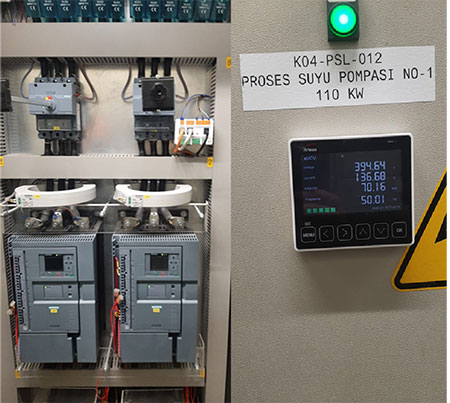

In order to evaluate the system, ESA was implemented using a device installed at the MCC panel. This system measured motor electrical signals—voltage and current—to calculate flow, pressure and power without requiring external sensors on the pump or piping. The hardware interfaced directly with the motor’s power supply, simplifying deployment by avoiding additional instrumentation. This approach provides several advantages:

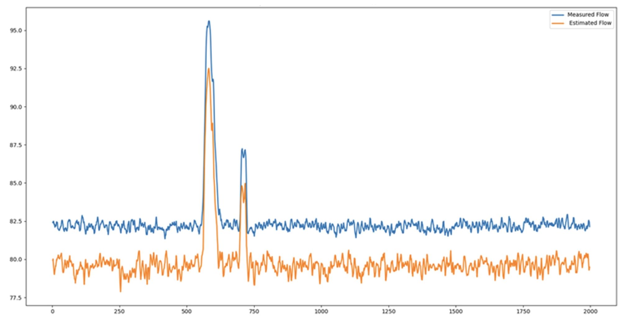

The ESA system incorporated AI algorithms to process electrical signals and estimate operational parameters. These algorithms correlated signal patterns with hydraulic performance, enabling flow and pressure predictions with a deviation of ±3% compared to on-site sensor data during validation. Beyond performance metrics, the AI analyzed signal anomalies to identify mechanical conditions, such as cavitation or bearing stress, by detecting irregularities like sideband noise in the PSD. The software presented data through graphical outputs—flow-pressure curves plotted actual operation against the BEP—with zones delineating efficient and inefficient regions. Power curves showed energy consumption across flow range, and time-series trends tracked 24-hour and annual performance. These tools provided a detailed diagnostic framework for assessing pump behavior.
Analyzing Energy Consumption & Mechanical Health

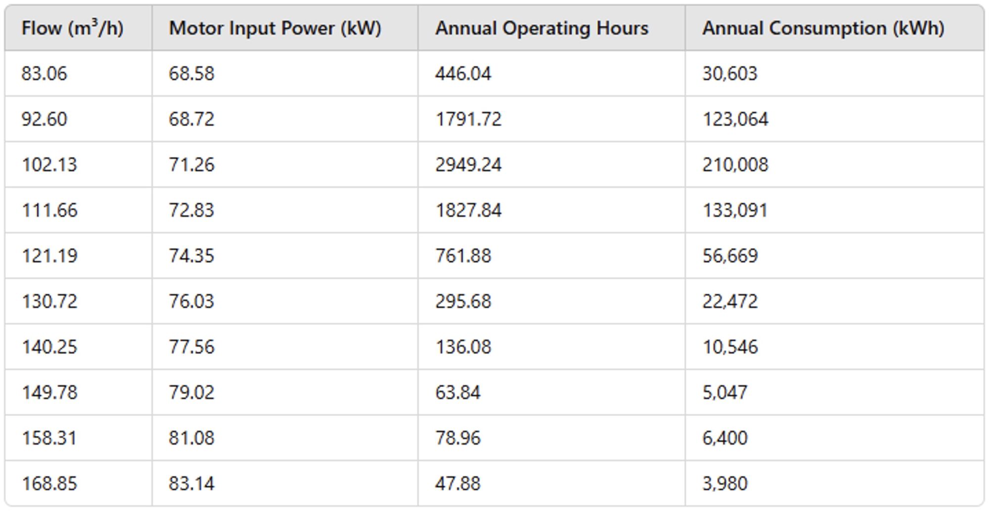

Operational data over one year revealed energy consumption patterns at various flow rates. At 83 m³/h, motor input power was 68.58 kW, rising to 83.14 kW at 168 m³/h. The low-flow bias—concentrated at 90-115 m³/h—drove inefficiency, with total consumption reaching 602,880 kWh annually.

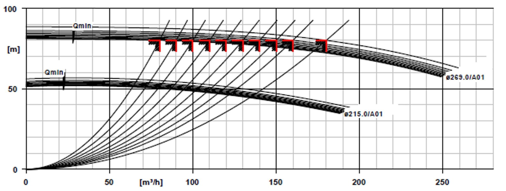

Alternative Pump Selection & Performance Optimization
To address these inefficiencies, an alternative pump model was evaluated. Key technical improvements include:

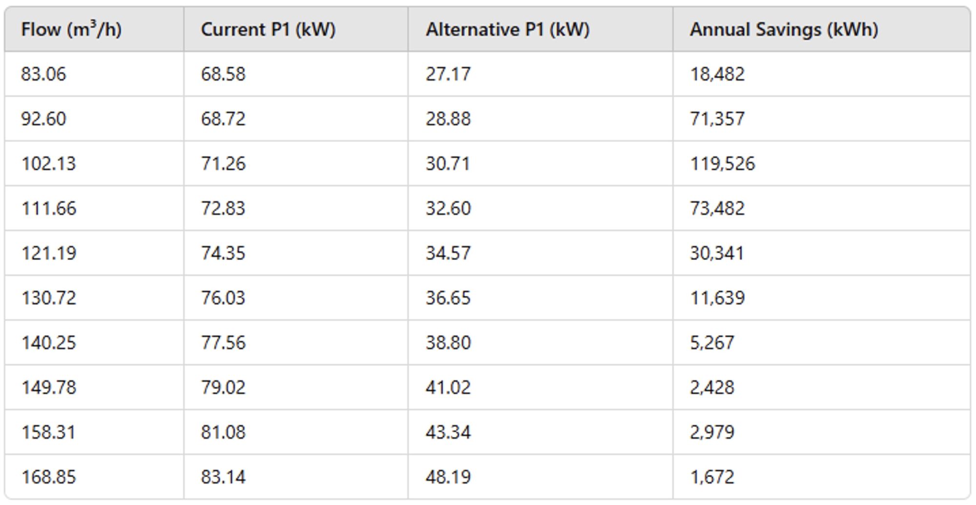

- Improved flow and efficiency: The alternative pump has a nominal flow rate of approximately 215 m³/h and a nominal power consumption of 55 kW. At its BEP, it operates with an efficiency of around 81.3%, a significant improvement over the current pump.
- Energy savings: With the alternative pump, the projected annual energy consumption drops to approximately 264,707 kWh. This represents an energy savings of roughly 338,173 kWh per year—a reduction of over 56%.

A key aspect of this case study was the validation of the sensorless monitoring approach. Side-by-side comparisons between traditional flow sensor data and the values estimated by the pump performance analysis software showed a high degree of accuracy, with deviations of only around ±3%. This close alignment validates the effectiveness of the sensorless approach and underscores its potential as a reliable alternative to conventional monitoring systems.
