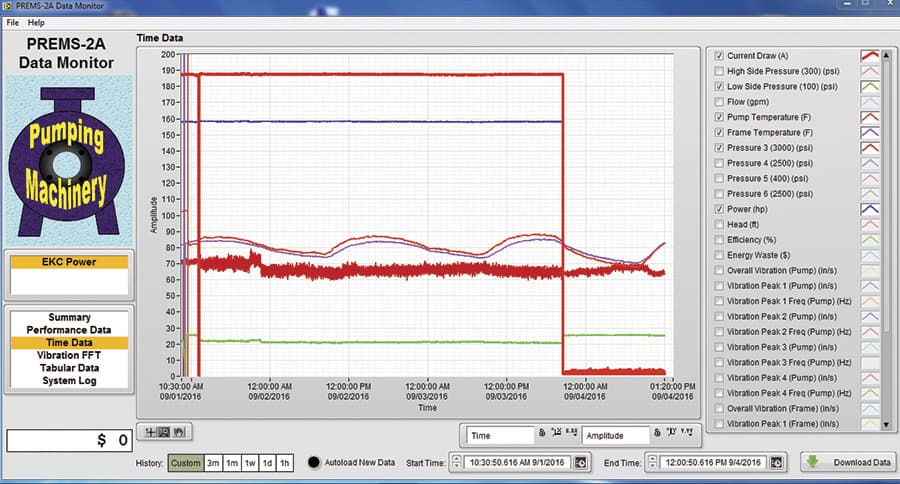

A pump reliability and efficiency measurement and data acquisition system (PREMS-2A) was installed to troubleshoot this case and track parameters related to pump reliability (vibrations, temperatures) and performance (head-capacity, power and efficiency). This part will explore data trends and analysis.

Because the flow was not readable by the flow meter at the time of the initial test, a simplified assumption was made regarding the pump’s actual head-capacity curve as supplied by the original equipment manufacturer (OEM)..jpg)
- Pump 2A generally operated between 3,600 and 6,000 gpm.
- Pump 2B operated between 4,000 and 5,500 gpm.
- Pump 2C operated between 4,000 and 5,800 gpm.
Separate Flow Test
A company that performs flow measurements obtained a flow record, from Sept. 9-16, 2016. If the plant is running, both pumps are running; if the plant is offline for an outage, one pump runs until the turbine is cooled down (about two to three days) and then all pumps shut off during the outage. If a short-term outage takes place, one pump will run because the turbine will still be hot. Once the unit is fired back up, both pumps will be running. During the earlier PREMS-2A tests, the team deduced the flow from the pressures, assuming non-degradation in performance. That translated to a flow range of 4,000 to 5,500 per pump. The flow-measurement company’s data, however, shows about 3,000 to 4,000 per pump when two run together, or 4,500 when one runs. This implies roughly 1,000 gpm degradation of the flow from what would be expected with the OEM curve. The company stated that its ultrasonic meter tends to read about 6 percent lower than the actual flow, which was confirmed by completing the pitot test in conjunction with the flow test. A typical 4,000 gpm reading would need to be corrected to approximately 1.06 x 4,000 = 4,240; for example, a 300 gpm correction, or a 700 gpm deficit compared with the OEM curve.
