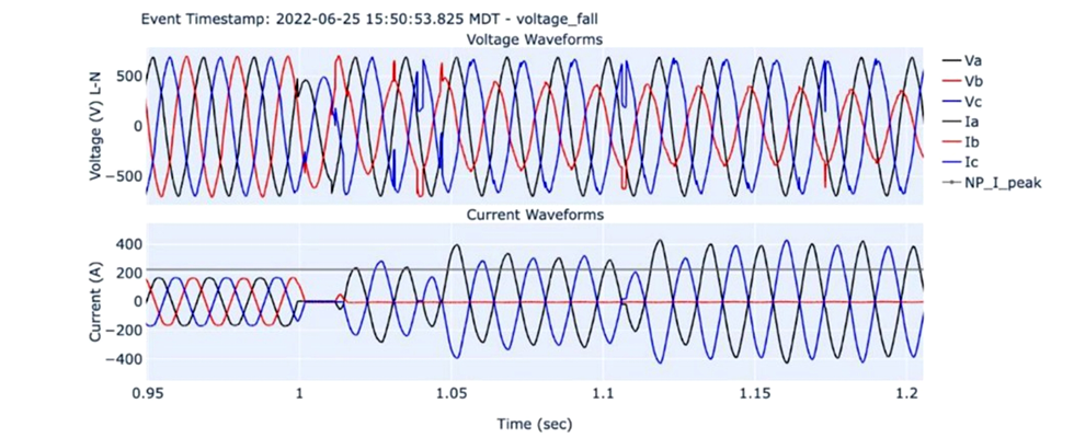

Monitoring power quality on a continuous basis allows for detection of adverse conditions early, even for assets within the power generation plant. Image 1 shows an example of a short duration single phasing event of a cooling pump. In this case, it was determined that the contactor operating the pump was showing signs of intermittent open circuit on one of its phases.
With continuous waveform monitoring and the appropriate algorithms for alerting to such events, even short duration single phasing events of less than 100 milliseconds can be used to track down and address problems before catastrophic failure occurs. In the example of Image 1, upon inspection of the contactor on a down day, visible degradation could be seen in the contacts of the contactor. The maintenance team replaced the contacts for minimal cost, and the intermittent single phasing stopped.
