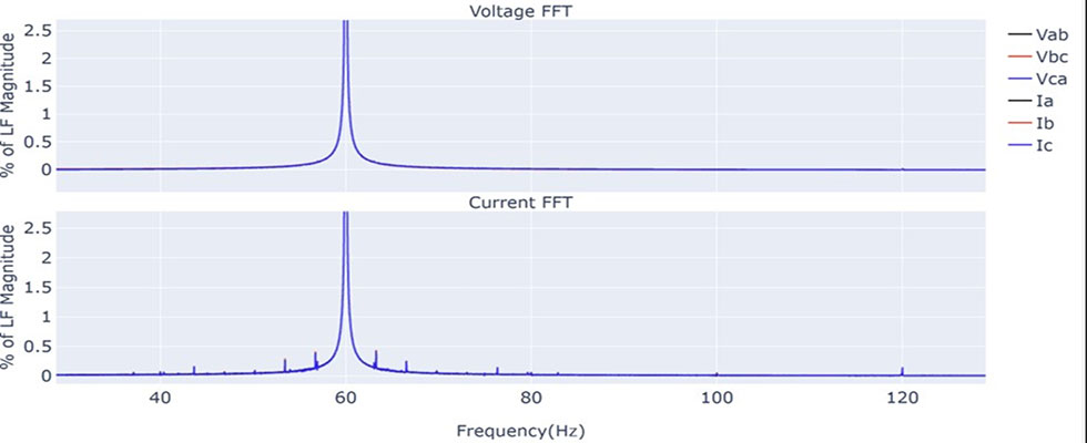

The methodology behind ESA involves comparing present-time waveform data with baseline data obtained during known healthy operating conditions. To understand the health of a pump, for example, a current waveform is captured, and the waveform is transformed to the frequency domain using a fast Fourier transform (FFT). The FFT output is the frequency spectrum and represents all the harmonics that are found in the voltage and current. Image 1 is an example of voltage and current waveforms represented in the frequency spectrum for a low-frequency range of 20-130 Hz.
Assuming the voltage input into the pump is purely sinusoidal at 60 Hz, any harmonic frequencies excluding 60 Hz in the frequency spectrum of the current are a direct consequence of the pump’s operation. In Image 1, the voltage spectrum is very clean while the current spectrum has some harmonics. Every individual harmonic or groups of harmonics can be mapped to specific faults—depending on the rotation or magnetization of the equipment and correlated geometries. For an example of a precisely mapped harmonic, it can be calculated that an impeller with nine blades or vanes will have a blade passing frequency of 9x running speed. If running speed is 1,790 rotations per minute (rpm), then the blade passing frequency will be 16,110 rpm or 268.5 Hz.

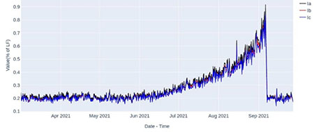

By looking at the frequency spectrum and then tracking individual harmonics over time, like the blade passing frequency, it can be determined if excessive wear is happening on a particular fault condition. In the case of the blade passing frequency at 268.5 Hz, it can be seen if excessive cavitation is occurring and how that may be pitting the vanes over time. Image 2 is an example of an individual harmonic amplitude plotted over a seven-month period. As the harmonic began trending upward over time and began to approach 1% of the line frequency amplitude, maintenance was performed, and the harmonic dropped back to its baseline.
Any deviations from expected baseline spectral patterns indicate incipient faults. With enough baselining and trending over time, precise maintenance practices and prescriptions can be implemented. Continuous waveform monitoring ensures these comparisons happen in real-time, so anomalies can be acted upon immediately.
