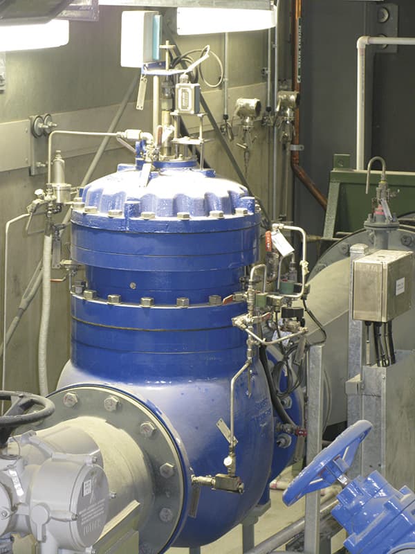

Pressure Drop Conditions
The valves needed to work primarily on high pressure drop conditions and occasionally at very low pressure drop conditions. The danger of these conditions is cavitation, an extremely damaging force with loud noise, excessive vibration, choked flow, and destruction and erosion of control valves. The damage can disrupt water distribution or lead to plant shutdown. To address this problem, all the valves were fitted with specialized, anti-cavitation valve technology, including two heavy stainless steel sliding cages to maximize the full flow capacity. The first cage directs and contains the cavitation recovery, allowing it to dissipate harmlessly. The second cage allows further control to a level as low as atmospheric pressure downstream. The cages are specifically engineered to meet the flow/pressure differential of each individual application..jpg)
