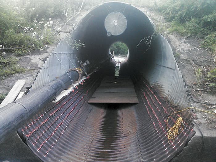

The length of the bypass was approximately 200 feet, and the team built rigging to hang the pipe along the inside wall of the culvert. Installers were able to flange the HDPE piping and set it up in 50-foot lengths ahead of time at the rental dispatch and maintenance yard. They delivered the four sections on a flatbed tractor-trailer. Once on location, the lengths of pipe were unloaded, lowered into the culvert one section at a time, bolted together and slid onto the rigging.

With the bottom of the culvert now void of water, the team could focus on the repair component, which was to build a concrete invert into the bottom of the culvert. While the construction was underway, the rental pump ran 24/7 for two weeks straight without an issue.
