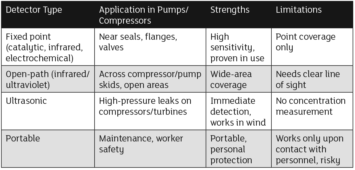

Types of Gas Detection Used
Operators often deploy a diversity of gas detection technologies on pumps, as each technology caters to specific leak scenarios and installation environments. Image 1 summarizes the main types of gas detectors—fixed point, open-path, ultrasonic and portable—along with their key strengths and limitations. This comparison helps illustrate why a diversified detection strategy is often necessary to achieve comprehensive coverage in industrial facilities.

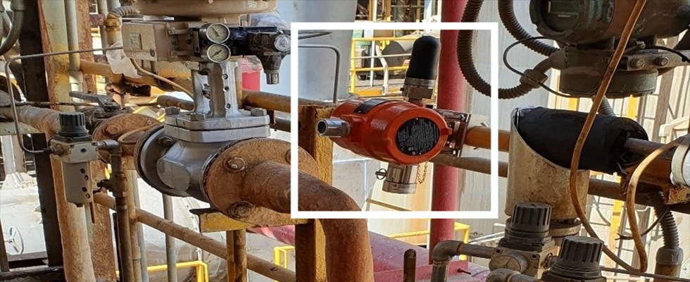

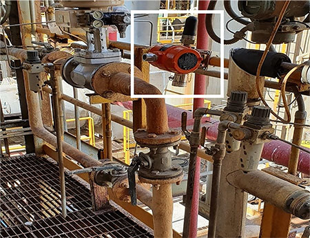

Case Study: Monitoring an Ammonia Gas Leak
Challenge: The user wanted to monitor ammonia gas leaking from the pipes and pipe flanges connected to a pump system. The challenge in installing a wired gas detector arose because power and signal cables in the facility were prone to being damaged by the high concentration (>90%) of sulphuric acid that was spilled or present in vapor form in this lead metal processing facility. Previous wired detectors had their cables damaged from long-term exposure in a corrosive environment. The user wanted a long-term solution that would eliminate the issue of corroded cables.
Solution: A WirelessHART network already existed in the facility. The gateway (i.e., industrial wireless router) was located about 100 meters from the pipe flange. The high density of piping made it difficult to run wires to a new wired detector, so deploying a WirelessHART gas detector was ideal in solving the challenge of inaccessibility. The nearby network of WirelessHART pressure transmitters provided a strong mesh network for a gas detector to latch on. The user was able to save at least $2,000 in cabling costs per detector just by selecting wireless gas detection over a wired option. More importantly, they were able to create monitoring points instantly without time to lay the cables.
pipe flange
