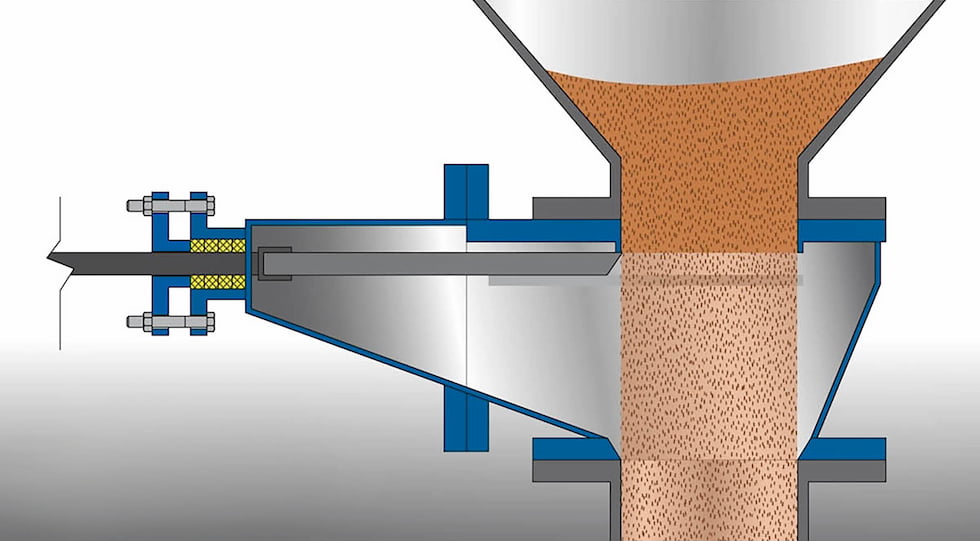

A specialized tapered-body knife gate valve has a displacement pocket fabricated into the valve body, which enables the valve to close through a standing column of dry, packed material.

Upset conditions (including pressure, temperature and media abnormalities that may occur during an upset event) need to be reviewed. Surge protection may be required for pressure upsets. Elastomer selection may be affected by temperature spikes. Slurries may settle and plug piping, potentially causing a variety of issues from spills to dangerous exposure. Valve selection can be altered if a normal flowing slurry or bulk media needs to isolate under a static condition or column of media.
An example would be selecting an isolation valve between a bulk feeder and hopper. Under normal flowing conditions, a standard knife gate would slice through the flowing column and isolate. However, if the bulk feeder stalls and the column fills, the standard knife gate cannot cut through the column of material to adequately isolate the feeder from the hopper for maintenance. Other possible solutions could be an O-port knife gate or specialized, tapered body knife gate with space fabricated into the valve body to displace the column of material.
