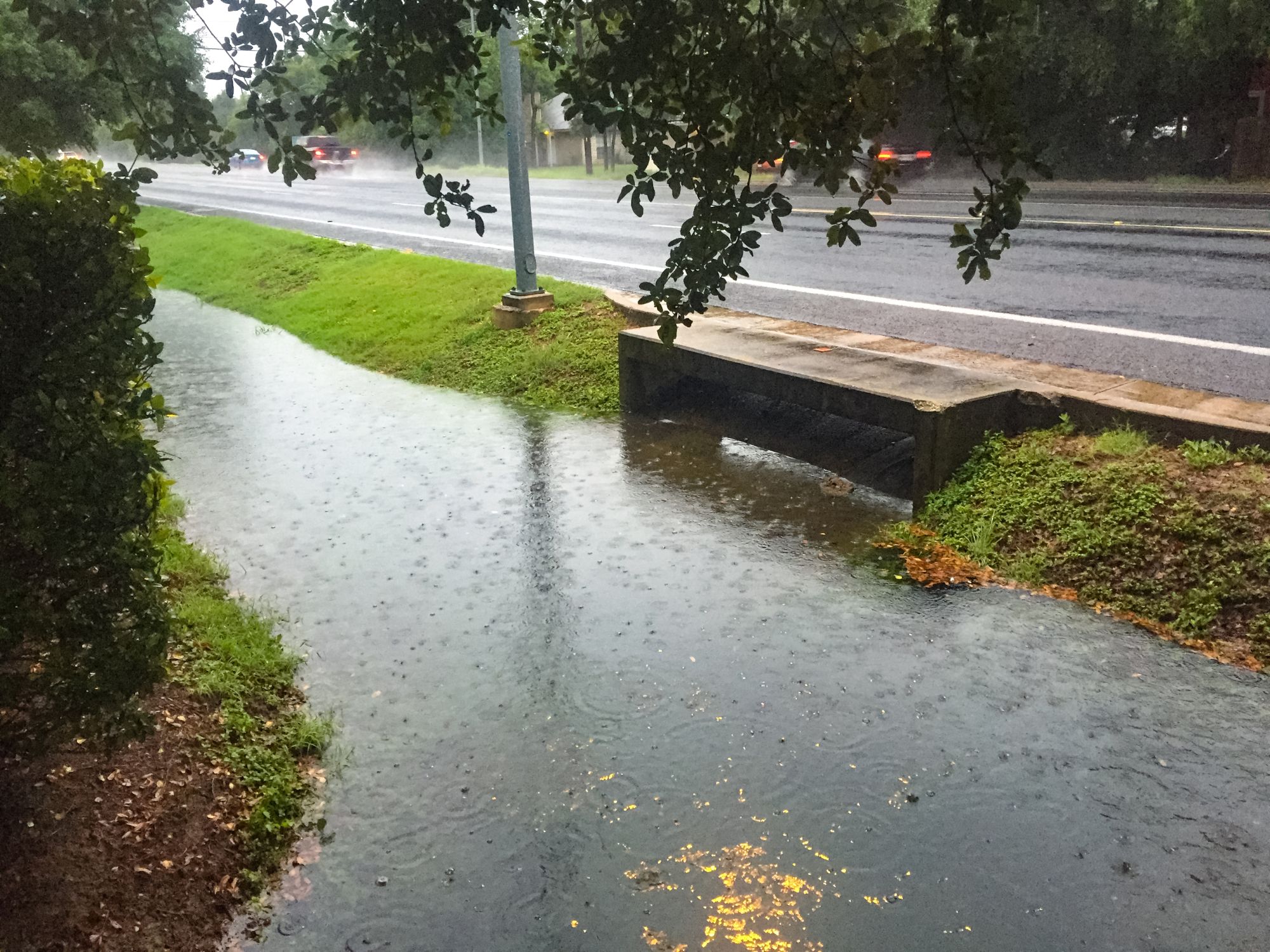

City of Austin urban flooding to be addressed with implementation of underground detention system
