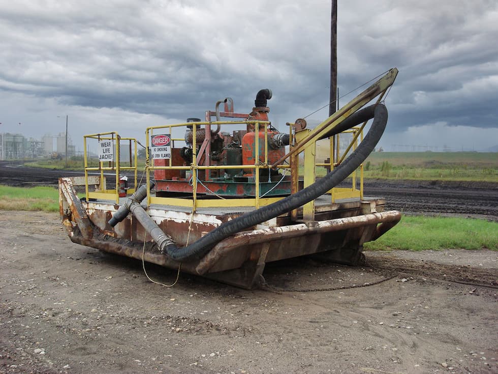

Prime pump on pontoon

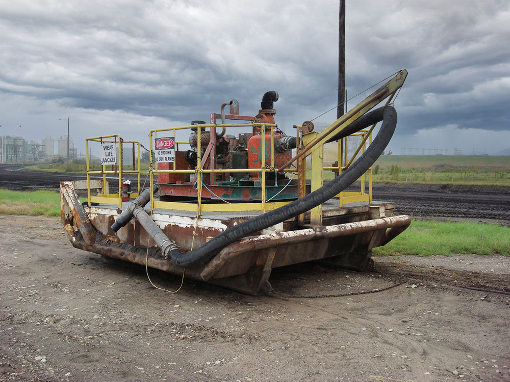

Self-priming pump on a pontoon
IMAGE 3: Self-priming pump on a pontoon

Some mining operations implement heavy-duty, self-priming pump systems with high kilowatts (kW) of power that are positioned on skids with pontoons. When rain is in the forecast, they are dragged to the lowest spot of the mine where water is most likely to accumulate. As the rainwater gathers, the self-priming pumps begin to float on the water. Equipped with a float switch, once the system begins to rise, the engine automatically starts and activates the pump. As the water level lowers, the pumps then automatically shut off.
The nature of these pumps requires them to not only pump water but also large abrasive solids and debris that get washed in. These pumps require the high head capability for pumping up the steep inclines of the mine pit walls. Dewatering mine pumps and their parts are made of rugged material for handling the abrasive solids that get suctioned into the pump along with the rainwater.
