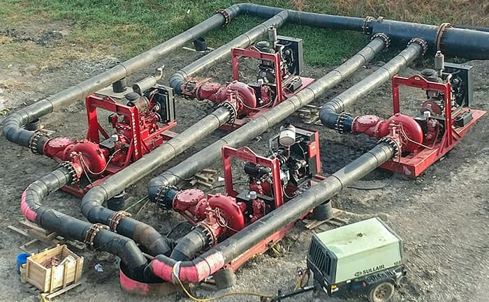

bypass pumpsImage 1. Bypass pumps prevented catastrophic sewer interruptions

The interchange work on I-29 near the intersection of US-275 included relocation of a 48-inch combined sewer interceptor line. This sewer, one of the main interceptor lines leading to the Council Bluffs Wastewater Treatment Plant south of the city, is vital to providing sewer service to tens of thousands of residents. An interruption would be catastrophic for the city.
For this portion of the project, a temporary bypass system capable of diverting flows up to 20,000 gallons per minute (gpm) was proposed. This system flows a distance of 1,400 feet around the work area and back into the sewer downstream of the active construction. The system includes three 18-inch pumps, each configured for flow capabilities of 7,000 gpm for a combined capacity of 21,000 gpm.
A fourth pump serves as a backup. In emergency conditions, this pump will automatically turn on through the use of float switches. Each primary pump pulls suction from nine feet below grade through an 18-inch high-density polyethylene (HDPE) suction pipe installed into an existing upstream manhole. The system discharges through a manifold into a single 36-inch HDPE pipe to the downstream manhole about 1,400 feet away.
