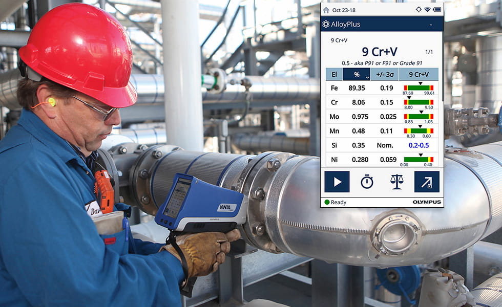

Handheld XRF Analyzers
Inspectors can use X-ray fluorescence (XRF) tools to quickly and nondestructively verify material composition. Positive material identification (PMI) using portable XRF analyzers is standard practice for critical applications, where inspectors can identify common alloys in a few seconds. The handheld design also enables inspectors to test fittings and pipes prior to installation or while they are installed and active.
![Diagnosing corrosion on a pipe](/sites/default/files/0320/Vanta_PMI_IMG_5145_combined.jpg)
Grade identification with XRF is determined by comparing elemental results to a library (typically more than 500 grades) of known grade specifications. Modern XRF analyzers can clearly display the concentration of elements detected and how they compare to the matched grade. Users can then see if the grade installed is the one specified in the facility’s piping design.
Handheld XRF can also detect corrosion susceptibility. For instance, XRF can diagnose susceptibility to sulfidic corrosion via silicon concentration; hydrofluoric acid (HF) alkylation via chromium (Cr), nickel (Ni), and copper (Cu) concentration; and flow accelerated corrosion via low Cr concentration. Knowing these risk factors can help save time and money by signaling when and where to schedule maintenance.
