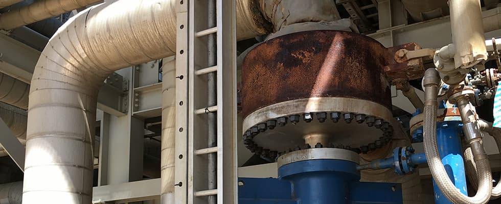

A chemical processing plant had been experiencing high vibration and bearing failures on their furnace water circulation pumps. This application uses a sealless combined pump and motor, due to the high pressure and high temperature water being circulated. This vibration and wear required that the motors be overhauled approximately once per year at a cost in excess of $100,000. These issues had been occurring since the pumps were first installed in the late 1990s. Investigations after initial commissioning of the units indicated that the vibration frequency being measured, 177 hertz (Hz), also matched the first bending mode frequency of the rotor; however, the phenomenon which excited this mode was not conclusively identified.
The leading theory at the time was that the bending mode was being excited by the stator slot to rotor bar passing frequency. Eliminating this forcing frequency would require a redesign of the shaft to change the natural frequency or a redesign of the stator and rotor to change the slot pass frequency. Therefore, the decision was made by the chemical processing plant to leave the design as-is and accept that the motors would require frequent repairs.

Eventually, new personnel took over the management of these pumps at the plant and decided to reopen the investigation into the vibration issue. Engineers were asked to assist in the root cause analysis. The investigation started by examining the effect of a 90-degree elbow in the suction line immediately upstream of the pump suction flange. Given the proximity of this elbow to the eye of the impeller, the hypothesis was that this elbow was causing flow-induced vibration at the frequency being detected at site (177 Hz).

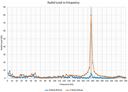

Radial load dominant frequency
IMAGE 3: Radial load dominant frequency

This simulation showed that the radial load magnitude, which occurred at 177 Hz, had been reduced by 92%, indicating that the oscillating behavior had been eliminated (Image 3). A plot of the radial load vector versus time confirmed this; the load now acted in a near constant direction with only slight variations in direction occurring randomly rather than at a constant frequency (Image 4). Because this load acted in a near-constant direction, it would not excite the shaft natural frequency, and it would allow the fluid film in the journal bearings to become fully established. This would result in extended bearing life.
