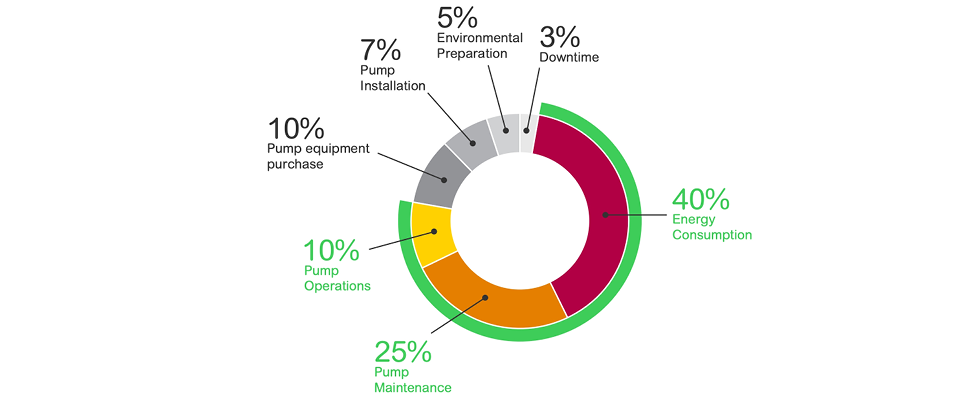

IMAGE 1: A typical pump station budget (Image courtesy of Schneider Electric)

One tangible benefit of digitization is energy cost reduction. Pumps often operate under conditions that deviate from their best efficiency points, leading to unnecessary energy consumption. With digital monitoring and control, facilities can optimize performance by operating closer to target curves, leveraging more efficient equipment and taking advantage of lower-cost energy periods. Additionally, analytics can identify energy waste and suggest corrective actions.
Digital technologies also enhance maintenance efficiency. Condition-based monitoring allows operators to detect potential issues before they escalate into costly breakdowns. For instance, pressure sensors and analytics can monitor pump suction and alert operators when performance begins to drift. This reduces the reliance on schedule-based monitoring and manual inspections and minimizes labor costs, enabling facilities to focus resources on more critical tasks.
