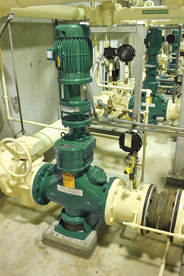

Dual-shafted grinders employ low-speed, high-torque grinding to break down troublesome solids. This configuration handles tougher items such as wood or rocks and is especially effective at shredding rags and consumer wipes when compared with single-shafted grinders or macerators.

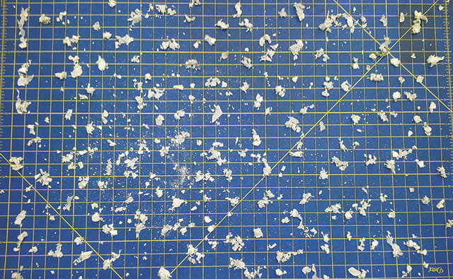

As the name indicates, dual-shafted grinders comprise two stacks with rows of hardened, steel cutters that rotate toward one another. The cutter teeth actively grab solids and pull them through the cutter stack, shredding solids into smaller pieces. The shafts rotate at different speeds, so the cutters interact like a pair of scissors—slicing the solids rather than crushing them. This slicing action helps ensure a consistently small particle size; most pieces are 1/2-inch or smaller (see Figure 1, page 56). Dual-shafted grinders employ top and bottom shaft bearings and robust mechanical seals to prevent shaft deflection or seal failure when grinding high volumes of solids, such as wipes, rags and organics.
An in-line, dual-shafted grinder system comes in two parts, ensuring an efficient and streamlined installation. The flanged steel housing is bolted into the pipeline at both ends, and a removable cutter cartridge—including two shafts of cutters, the gear reducer and motor—slides down into the housing. This setup simplifies maintenance inspections and repairs by allowing the pipeline to be put back into service when the cutter cartridge is removed.

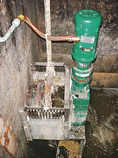

As rags pass through collections systems in either long trunk lines or in a series of pump stations, they tend to form "ropes" or rag balls as they recombine with hair and grease (see Image 1). When chopper pumps are placed further downstream in a series of stations, especially last in a line of pump stations, the enormous volume of rag balls and wipes that have accumulated can create significant challenges.
