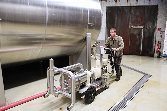

Pumps are used for a variety of applications during winemaking and are critical to the process. “Pumps are important pieces of equipment for us,” said Cerveau. “Because we use our pumps in a variety of locations, we usually have a few that are mounted on a mobile cart so we can easily move them around the winery. We use them in our pressing center, where it’s a 24/7 operation, as well as around the winery to fill tanks or transfer wine from one tank to another. In addition, we use a pump to fill all of our wine bottles. If our pumps go down, the operation stops.”

DESCRIPTIONImage 3. Some of Bailly Lapierre’s success can be attributed to the company’s eagerness to implement new technology into its winemaking operation, including innovative automation equipment.
The pumps were specifically designed for use in the food and beverage industry, which requires exceptional hygienic operations. What sets the pumps apart is a sealless design that incorporates a hermetic pump head with a self-adjustable eccentric shaft protected by a double-wall stainless steel bellows that ensure long life and product safety.
The pumps also reduce the risk of product contamination and costly leakage thanks to the way they are constructed, eliminating mechanical seals, packing and magnetic drives. This design has helped the pumps earn certification from EC 1935/2004, EHEDG, 3A and FDA for use in food-processing applications.
The pumps offer benefits including strong vacuum and compression effect for enhanced line stripping and optimized product recovery; low shear rate; self-priming and dry-run capabilities; exceptional volumetric consistency; no slip; and almost completely pulsation-free operation. Because the pump includes only two wear parts, maintenance is easy and can be performed while the pump is inline.
“The high flow rates are a key feature; since we deal with big volumes of liquid, we need a big flow. Another great feature is the strong suction,” Cerveau said. “Because the pump is located in the pressing area, it has to suck the liquid from a lower level and send it through about 40 meters of piping. This isn’t possible with some other pumps. Additionally, just as we have designed our presses to handle the grapes as gently as possible, we love the fact that the pumps feature no excessive shear that puts friction on the wine. But the best benefit for us is the higher rate of product recovery. The pumps can completely drain all of the juice from the piping and from inside the tanks.”
A key to the pumps’ enhanced product-recovery capability is their unique conveying principle. This principle is based on two stainless-steel components—the static cylinder and the moving piston—driven by an eccentric shaft, which generates a circular movement. Through this movement the inner and outer chambers are formed, which displace the liquid from the suction side to the discharge side with an impressively consistent and accurate flow. Given that the pump can run dry, the rotation of the parts creates a compressor effect that facilitates the stripping of discharge lines.
