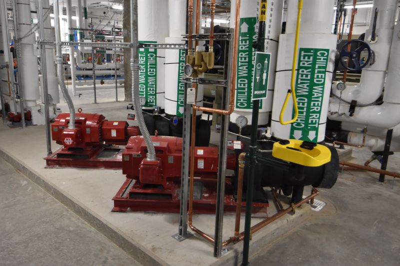

Packaged pump systems have certainly come a long way. Originally embraced for their space-saving design, simplified installation and advanced communication capabilities, modern packaged pump systems are transforming the heating, ventilation and air conditioning (HVAC) industry’s approach to pump system deployment.
Traditionally, pumps in commercial buildings were sized to meet maximum system demand without the flexibility of variable speed operation. Consider a hotel, for instance, where peak water usage occurs in the morning as hundreds—or even thousands—of guests get ready for the day and again in the evening when they prepare for bed. Midday, demand drops sharply, yet a fixed-speed pump continues to run at full capacity, cycling on and off with no ability to modulate flow. The result is wasted energy, unnecessary wear and higher operating costs.
This challenge is magnified at scale. Electric motors account for more than half of all energy consumed in the United States1, making pump efficiency a critical target for savings. As demand on building systems becomes more complex and regulations continue to tighten, the industry is turning to variable speed drives and packaged pump systems that align output with real-time demand and deliver sustained performance.
Regulations, however, represent just one piece of the puzzle. The focus is shifting from systems that simply comply with standards at installation to those that provide actionable data, integrate seamlessly with other building systems and sustain performance long into the future.
