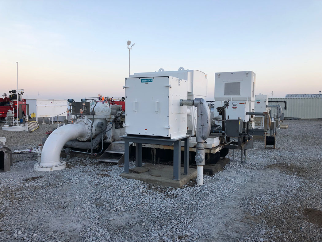

Common Application
A pipeline owner would like to be able to operate a 3,000-horsepower (hp) pump between 1,400 and 3,600 rpm. When using other motors, operators can traditionally only reduce the volume of the flow by applying valves and/or other flow dampening devices. These valves and dampeners can waste energy. This can be compared to holding down an accelerator on a car and using the brake to control the speed.
Motors can operate on VFDs at different speeds to produce a variable flow without wasting brake energy. The VFD can be run at a lower power output and reduce the energy used to drive the entire system without having to reduce the flow using energy-wasting valves or dampeners.
