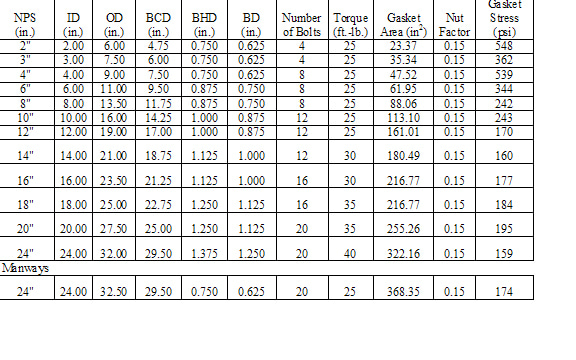

Table 1 shows the resultant gasket stress when the suggested torque (Figure NM9-3) is used. Obviously, the resulting gasket loads are well below the minimum threshold necessary to seal with a PTFE-based gasket.

However, at this time, no suitable answer is available for this dilemma. If the vessel or piping will use PTFE gaskets instead of elastomers, these gaskets have little chance of working unless the recommended guidelines are changed. This is the main reason that end users experience gasket problems. There are two stages of this issue. In defense of the equipment manufacturers, they are able to increase the flange load capability of equipment to allow torques that provide the required stress. However, they have to make these changes in the design stages before quoting the equipment. Most manufacturers will make the appropriate adjustments to lessen this complaint.
