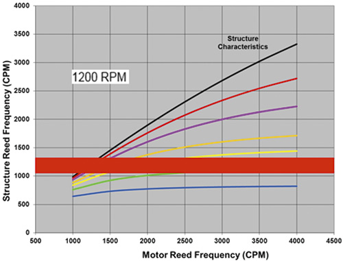

Satisfactory frequency separation margins are not easily achieved in applications that have certain design operating speeds (or motor speeds). These applications are more vulnerable to resonance and increased vibration because of typical structure characteristics and available motor reed frequencies. Conversely, avoiding resonance and experiencing lower vibration with some design operating speeds is easier when compared to others. Consider Figure 1. It shows the structure reed frequency versus motor reed frequency, with plots of different values of structure characteristics as defined in ANSI/HI 9.6.8. Figure 1 enables the structure reed frequency to be determined graphically using the motor reed frequency and structure characteristics.

Figure 5. The structure reed frequency versus motor reed frequency at 1,200 rpmUnits of Vibration for the Purpose of Standard Acceptance Criteria
Units of vibration in terms of velocity are best used as the basis of standard vibration acceptance criteria, with velocity root mean square (RMS) being the industry accepted format. However, at some point, the design operating speed begins to move away from the typical structure reed frequencies encountered, with frequency separation margins increasing as the design operating speed decreases. This phenomenon can be understood from Figures 2 through 7 that illustrate the design operating speed considerations. At lower speeds, the frequency separation margins are far greater than the minimum recommended 10 percent, and the resulting vibration is very low—well below the velocity acceptance criterion that is useful at the higher speeds.
