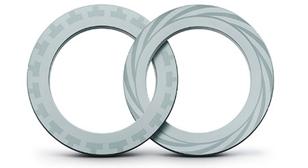

Across industries, several advanced sealing strategies have become foundational. Dry gas seals (DGS) are widely adopted for gas applications due to their noncontacting design, which forms a stabilizing gas film between grooved faces. This configuration can minimize emissions and eliminate the need for liquid lubrication. In more demanding services, tandem and double seal configurations can provide redundancy and enable safe containment in the event of primary seal failure. The DGS system is often supported by gas panels that condition and supply clean, dry sealing gas while controlling flow and pressure. Conditioning the sealing gas is critical to remove solid particles and moisture, as contamination from solids or liquids is a leading cause of dry gas seal degradation and premature failure.

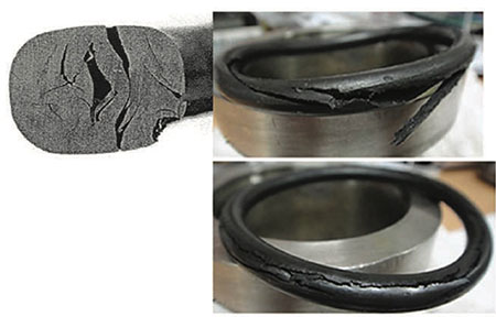

In high-pressure hydrogen systems, rapid gas decompression (RGD) is a critical failure mode. When hydrogen is absorbed into elastomeric materials and the system experiences a sudden pressure drop, the gas expands rapidly within the seal, potentially causing blistering, cracking or rupture. To mitigate this risk, RGD-resistant elastomers are used in combination with mechanical design features such as backup rings and optimized seal cavities that limit extrusion and support the elastomer during decompression events.

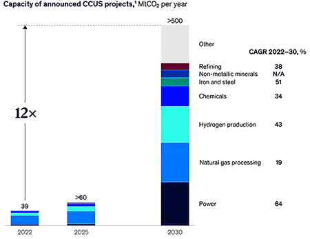

Sealing CO2 in advanced systems—such as carbon capture, utilization and storage (CCUS) or supercritical CO2 power cycles—presents unique challenges. Above 88 F (31 C) and 7.4 megapascals (MPa), CO2 enters a supercritical state that exhibits both gas-like and liquid-like properties. Minor fluctuations in temperature or pressure can cause phase transitions, leading to condensation or dry ice formation, which can disrupt sealing interfaces and damage seal components. To mitigate these issues, seal designs aim to maintain CO2 in a stable phase at the seal face, utilizing gas conditioning and heating systems.

Dry gas seals routinely use precision-textured sealing faces, often produced via laser or etching, to support gas film formation, with specific patterns tuned to the application’s pressure and fluid properties. Optimized surface patterns help promote stable gas film formation under high-pressure CO2. These design enhancements work together to ensure reliable containment in high-pressure CO2 systems.
RGD is also a concern for CO2 applications, as absorbed CO2 in elastomeric seals can expand violently upon sudden depressurization, leading to seal damage. To mitigate this risk, elastomers such as specially formulated grades of FKM, FFKM and HNBR are selected for their demonstrated resistance to RGD effects. Proper material selection, in combination with seal design features like backup rings and controlled cavity clearances, is essential to maintaining sealing reliability during depressurization events.
