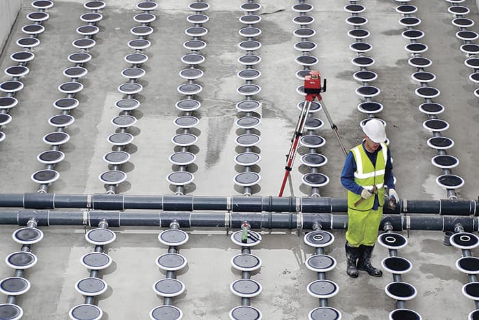

The supply of oxygen to four aeration tanks is now handled by five centrally controlled turbocompressors.
