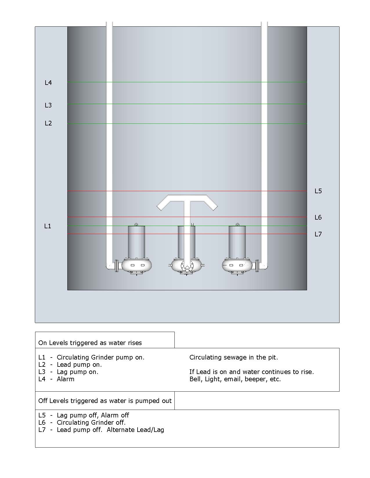

- Select the pumps and control panel. Some manufacturers offer the following options—high head, low flow; low head, high flow; or bi-directional. Most high-traffic commercial or institutional facilities would require low-head-high-flow units, since most of them need to pump up just one level to the main sewer line. Other, more problematic installations would benefit from a bi-directional system that offers the advantage of dislodging a possible wad and doubling the life of the cutter.

- Assess the severity of the specific sewage pit. In the event of a particularly problematic sewage collection pit, consider installing a third pump that would discharge in the pit. This would greatly facilitate the processing of the solids and would keep sediments in suspension while one of the other pumps is evacuating the pit. Refer to Figure 1 for a typical three-pump system.
There is great value in doing one’s homework in the process of matching a grinder/cutter/shredder sewage pump with a given sewage collection pit, but nothing can substitute the experience of a service company with a proven track record of solving sewage handling problems.
| Figure 1. A three-pump grinder/cutter/shredder system |
